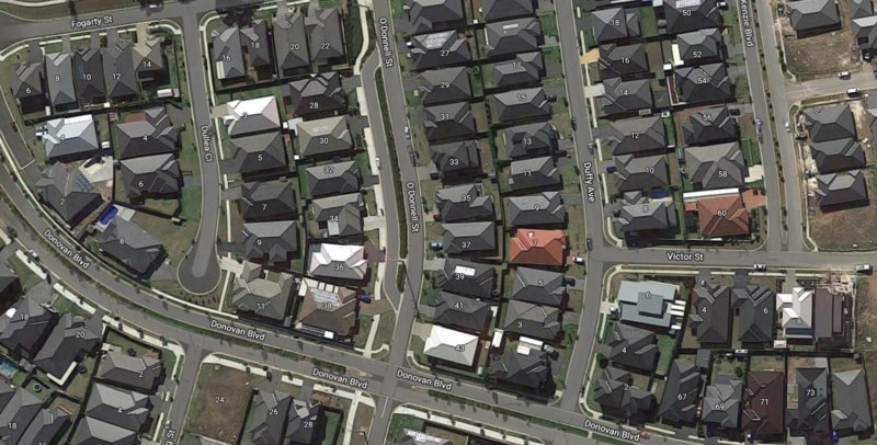

old man emu Posted December 29, 2017 Share Posted December 29, 2017 If you fly gliders out of Camden, or use the airspace southwest between Bankstown and Camden, I wonder if you can give me some information? Have you noticed any changes in the strength or direction in the winds, or in the behaviour of thermals over the past five years or so? The background for my question is that, over the past five years, there has been an explosive increase in the area which has changed from pasture land to residential use. The majority of houses which have been built have dark coloured roofs. What I am wondering is, "Has the heat stored in these dark coloured roofs due to their low albedo resulted in increased heating of the air moving over the residential areas, thereby increasing the size and strength of thermals, and increasing the strength of the afternoon nor'easterlies. Albedo is the measure of diffusive reflection of solar radiation out of the total solar radiation received by a body. A high albedo means it reflects a lot of solar energy and a low albedo means it absorbs a lot of solar energy Here are some sample albedo values. The range of possible values is from zero (totally unreflective) to one (fully reflective). New asphalt, 0.04 - 0.05 Aged asphalt, 0.1 - 0.12 Bare soil, 0.17 Deciduous trees, 0.15 - 0.18 Green grass, 0.25 Aged concrete, 0.2 - 0.3 New concrete (traditional), 0.4 - 0.55 New concrete with white portland cement, 0.7 - 0.8 Water, 0.03 - 1.0 Soil (Dark/Wet) 0.05 Soil (Light/Grey) 0.4 Sand 0.15 - 0.45 galvanized steel - 0.24 terra cota tile - 0.28 tar & gravel - 0.33 Notice that the good old terracotta tile has an higher albedo than trees, so the old areas of Sydney might be cooler than the the bush they replaced. And I'll castrate the first bloke who introduces libido to the discussion. 2 Link to comment Share on other sites More sharing options...

Old Koreelah Posted December 29, 2017 Share Posted December 29, 2017 ... the area which has changed from pasture land to residential use. The majority of houses which have been built have dark coloured roofs... Interesting point, OME. I bet the dark roofs cause more thermals. I despair for my country when I see so many dark-coloured houses- totally dependent on air conditioners to cope with Australia's not climate. No wonder our power network overloads on hot days. No verandahs. Bugger all eaves, near-black walls and roof. After two centuries in this place we've learned nothing. Dumb. 4 Link to comment Share on other sites More sharing options...
old man emu Posted December 29, 2017 Author Share Posted December 29, 2017 The fault lies with the people who do the appearance design of these buildings. After all, they are calling for dark grey roof tiles, which are made by adding colouring compound to the brick pre-mix. They could just as easily call for terracota colours and the manufacturers would simply change the colouring compound. Same for the bricks. Why are the buildings on the Greek Islands, such as Santorini, white? Why do men in the Middle East go about in white clothing? It's all about taking advantage of albedo rates. We did develop a building style suited to a hot, dry climate, but you can't have houses like this when developers want to cram as many house lots as they can per acre as they have done in Gregory Hills, near Camden Link to comment Share on other sites More sharing options...
Old Koreelah Posted December 30, 2017 Share Posted December 30, 2017 ...you can't have houses like this when developers want to cram as many house lots as they can per acre as they have done in Gregory Hills, near Camden. I disagree, OME. Of course we can design hot-climate housing for small blocks. It just requires a little imagination. Australia produces world-class architects, but too many of them are working overseas where their talents are appreciated. Back home, most people have to take what they can get- and too much of it is crud. Near-identical, poorly-designed houses with uniform high metal fences and no room for kids to play. Slums of the (near) future. Australia's love affair with the individual houses is no longer appropriate when suburban blocks have become so small. Many of our social problems stem from expecting nuclear or single-parent families to live in urban feedlots for humans, far from services and family support. The escalating cost of Childcare for busy young parents is being matched by the escalating cost of housing our idle elderly. Can't anyone in power see the obvious solution? We'd be far better off learning from people overseas, and living in small unit blocks with shared facilities and outdoor space. Several generations in the one building; neighbours of all ages to help each other and enrich lives. Many of our immigrants already do this. Why can't we learn from them? 1 Link to comment Share on other sites More sharing options...

coljones Posted December 30, 2017 Share Posted December 30, 2017 I disagree, OME. Of course we can design hot-climate housing for small blocks. It just requires a little imagination. Australia produces world-class architects, but too many of them are working overseas where their talents are appreciated. Back home, most people have to take what they can get- and too much of it is crud. Near-identical, poorly-designed houses with uniform high metal fences and no room for kids to play. Slums of the (near) future.Australia's love affair with the individual houses is no longer appropriate when suburban blocks have become so small. Many of our social problems stem from expecting nuclear or single-parent families to live in urban feedlots for humans, far from services and family support. The escalating cost of Childcare for busy young parents is being matched by the escalating cost of housing our idle elderly. Can't anyone in power see the obvious solution? We'd be far better off learning from people overseas, and living in small unit blocks with shared facilities and outdoor space. Several generations in the one building; neighbours of all ages to help each other and enrich lives. Many of our immigrants already do this. Why can't we learn from them? It used to be a 15 Square (about 10m**2) on a quarter acre block. The norm now appears to be 25m**2 on a 1/8 acre block, filling it to the boundaries with no green space, no eaves, much A/C and electric clothes drying (McMansions) - the new age slums are with us now. 4 Link to comment Share on other sites More sharing options...
Jerry_Atrick Posted December 30, 2017 Share Posted December 30, 2017 certainly looked that way from the aerial photograph, above Link to comment Share on other sites More sharing options...
