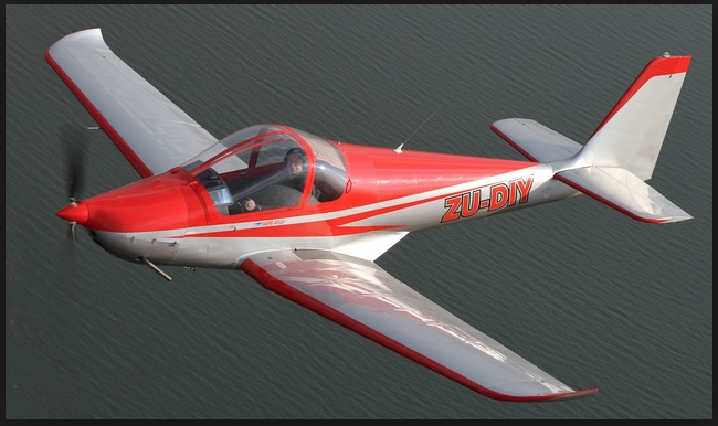

pylon500 Posted April 23, 2018 Share Posted April 23, 2018 Aircraft is (was) a Kappa Sova, all metal with retracts, 912ULS and often a variable prop, built in the Czech Republic. There are a few of them here in OZ, thought to be a nice plane. Yep, another one of those, "Hey, watch this," moments. Link to comment Share on other sites More sharing options...
Teckair Posted April 24, 2018 Share Posted April 24, 2018 Aircraft is (was) a Kappa Sova' date=' all metal with retracts, 912ULS and often a variable prop, built in the Czech Republic.[ATTACH=full']54845[/ATTACH]There are a few of them here in OZ, thought to be a nice plane. Yep, another one of those, "Hey, watch this," moments. I don't understand why it was going so slow it nearly stalled when they pulled up to make the turn. Absolute madness could only end one way. Link to comment Share on other sites More sharing options...
