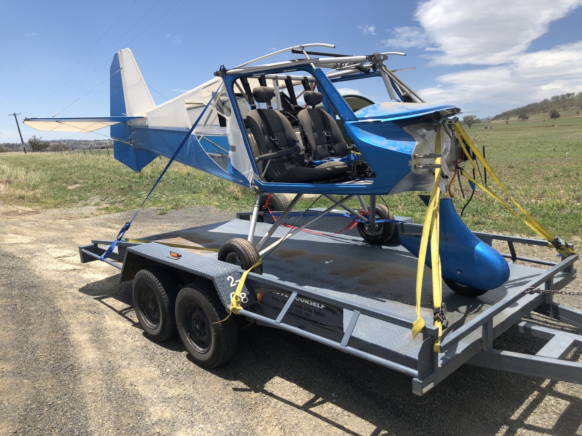

Bubbleboy Posted February 17, 2019 Share Posted February 17, 2019 I need to buy a prop for my Rainbow Cheetah aircraft. It is the older Brother to the current SkyReach Bushcat. Im not looking to start a slanging match on here I just need peoples lived experiences of what they have used and any positives and negatives. If its too bad an experience, maybe message me direct. The manual recommends a Kiev prop. Just looking for other options. Aircraft will not be used for training. Just my toy. I need a 3 blade to go on a Rotax 912ULS. Regards Scotty Link to comment Share on other sites More sharing options...
