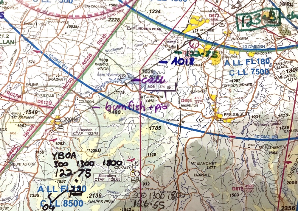

APenNameAndThatA Posted April 29, 2020 Posted April 29, 2020 I managed to pass my nav flight, so I thought I would share some of my tricks - some of which came from here. I used removable sticky tape to write colour-coded cues for radio frequencies, altitudes, radio calls and transponder/ATIS/QNR and pre-landing checks. I drew five mile circles around all the aerodromes, and five and 10 mile circles around the aerodrome that I intended to land at. That prompted me to notify aerodromes when I was passing close to their pattern, and do landing checks (five miles) and do approach calls where I was landing (10 miles). By doing the call at exactly 10 miles, ETA = T + 7, in my plane. I also coloured the border of the different maps with different highlighters. That enabled me to get the correct side of the correct map easily. For my destination airport, I wrote the elevation, circuit height and overflying height, CTAF, runway names, and if the circuit was left or right (S or Z - shaped) so I could picture the runway names and dead side as I approached the aerodrome to overfly it. With the heights all written down, I would not have to do maths under pressure. I must say, none of this info is presented this way on electronic displays, so at the moment, I plan on using paper maps for navigation and GPS just to confirm my position. All comments welcome, and the more critical the better - negative feedback is valuable. 3
APenNameAndThatA Posted April 29, 2020 Author Posted April 29, 2020 P.S. You can also use the removable sticky tape to sticky tape shut the bits of the map that I was not going to need. Apart from that, I was just using the standard sheet with the headings and times, and a couple of checklists, especially the clear off checklist.

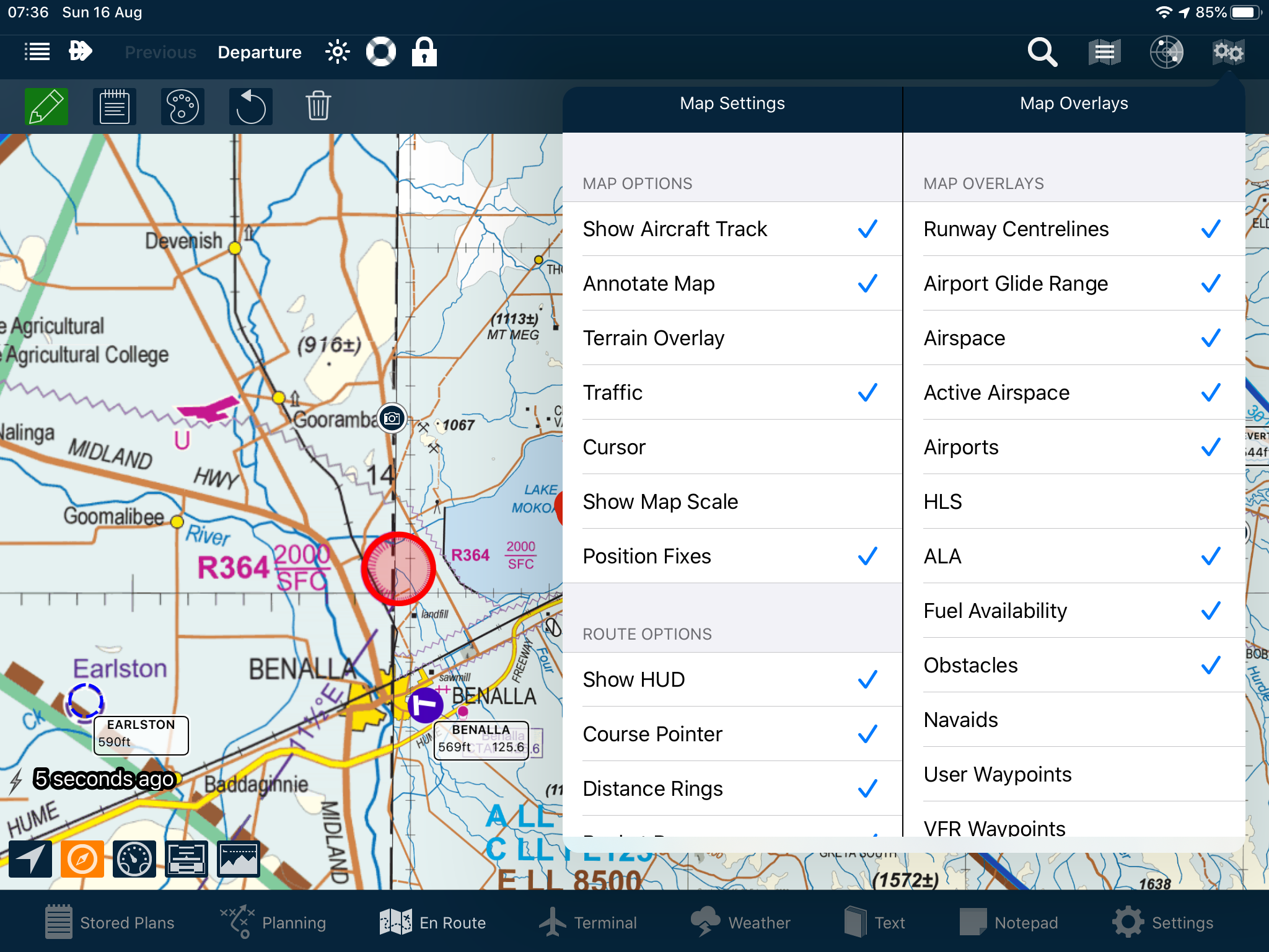

Paulmilo Posted August 15, 2020 Posted August 15, 2020 Bruce Tuncks said: Clear tape you can write on and which does not damage the map when it comes off? Where do you get that? I like to use ozrunways as well as a map. most of the time, you just have to keep the blue plane near the pink line on the display... and I reckon a smart guy could set it up so that you got a reminder when a radio call was required. Since I'm not smart, I like the idea of marking the map. AvPlan and I assume OzRunways allows you to ‘draw’ on your map (annotate) so you can combine “old skool“ with your EFB. I draw on things like radio calls and L / R hand ccts. Under settings, select annotate and then you can draw, erase etc.

Bosi72 Posted September 10, 2020 Posted September 10, 2020 Do whatever makes your workload easier. Regarding your actual markings, do you really want to be at A018 a couple of miles before Mt Joyce (1539)?
