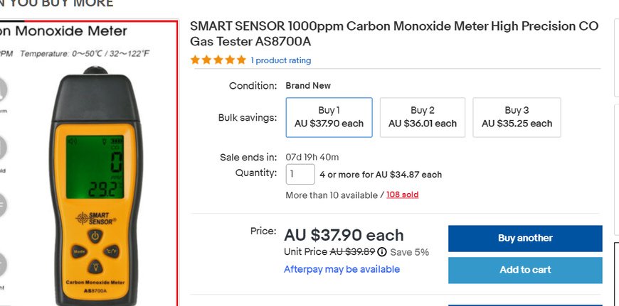

RFguy Posted January 20, 2021 Posted January 20, 2021 (edited) this is the one I bought that I liked the most. Note- ideally, a room CO detector should be an aspirating type, but in an aircraft there is using enough air movement to enough the sensor gets hit -glen Edited January 20, 2021 by RFguy 2
Blueadventures Posted January 20, 2021 Posted January 20, 2021 They look a good unit I see they trigger alarm at 24 ppm in less than 60 secs. The Quell units would need testing and doing a comparison and meet a standard that is at 50ppm alarm in 60 to 90 minutes, so may be pretty ordinary performance. Not that 50ppm will kill you just start to affect you. I like the compactness of mine. It’s interesting to see the number rise to about 14 on a fast decent. Usually about10ppm on reduced power decent. I’ll alter my exhaust pipes more down to get the exhaust into the air flow. I’ll check my specs in the manual when out at hangar next. Working OT this weekend and wiring a boat so no time to call out there soon. If I didn’t purchase the oneI have I’d get the one you show. A mate has the Quell one and has purchased the one that RAA sell. Cheers 1
RFguy Posted January 20, 2021 Posted January 20, 2021 (edited) that one shows 2 x what the CO gas only $$$ one shows. always from low to high concenrations. That's pretty good. I can personally vouch for it. As usual, they all have about 100 second startup time. The Quell one I understand from my reading is a multi gas sensor also. with a fault condition in an aircraft I have seen it reading over 700 ! ... but the gas concoction was also stinging my eyes ! Edited January 20, 2021 by RFguy

RFguy Posted January 20, 2021 Posted January 20, 2021 (edited) right, it is cheap but it is NOT a real time device.... not useful fault finding with that sort of slllooowww response time for low level... suggest the one I got. 3 x AAA batteries, will last about 12 hours.. maybe 20. Edited January 20, 2021 by RFguy
