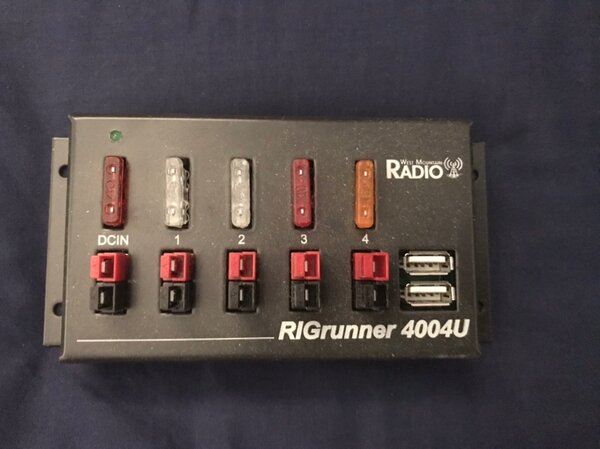

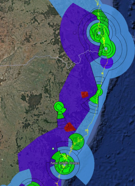

horsefeathers Posted February 4, 2021 Share Posted February 4, 2021 20 minutes ago, Garfly said: It could be and would be for all true safety intents and purposes ... but for the infamous over-reach and haughty contempt of the mandarins. Lets put some real world numbers for the Sky Echo 2 out there, just to inform the debate a bit. My SkyEcho is mounted on the top of my Jabiru windscreen, fyi. This morning, at 3,000 ft, I was able to see ADSB traffic approx 190 km away (using Ozrunways), from behind me. Also, we get a fair few Qantas Link aircraft overhead, approx 25,000 ft, typically coming out of Brisbane. Never have any problem picking them up I can see coastal traffic (about 50km away as the crow Jabiru flies), typically flying about 1,500/2,500 ft, with hills in between. Using FlightRadar 24, I can usually see my own aircraft while flying, or look at the tracking after i landed. I unfortunately don't know how good the reception is of my SkyEcho, and I'd love to be able to test it with another aircraft sometime. All in all, reception is brilliant, and more than sufficient for ADSB-IN, and so far with limited testing, ADSB-OUT seems more than adequate for a (say) 30Km safety zone 2 3 1 Link to comment Share on other sites More sharing options...
