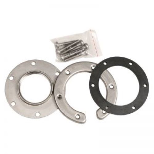

skippydiesel Posted July 7, 2023 Author Share Posted July 7, 2023 Just so we are all "on the same page" about what is proposed: The tank has been made to facilitate a fuel level pressure sensor, screwed into a small flange at the bottom of the tank. As you may know from other conversations, the fuel level pressure sensor consent just isn't working. The time has come to consider alternative fuel level sensors. So far all of the alternatives would seem to require fitting to the top of the tank. After taking appropriate precautions against fuel vapour ignition, I envisage cutting a circular hole in the top of the tank and installing something like this: The sensor would then be attached to this flange. There will be a need to ensure that the flange & studs are well sealed (this is where I am looking for a cost effective product). The sensor will come with its own gaskets. I would seal a "79 Commodore.) withe the same care and attention as I would bring to my aircraft. What will work for a vehicle will altos work for an aircraft ,given the same fuel type, location of flange and metal fuel tank. If I "cock-up" the modification, the risks are: some fuel spillage (not a massive leak), in cockpit fumes, which will impact on me, from discomfort to explosion, both of which I seek to avoid. The way I see it . the appropriate product will: Chemically secure (low strength) the inner flange, to the tank wall Seal the studs where they penetrate the tank wall. Seal the outer flange, to the external surface. Various processes, to achieve a successful result, have been carried out in the automotive/aircraft world for the last 100 years - its not the problem some would hint at - it just requires selecting the right sealing materials. 1 Link to comment Share on other sites More sharing options...
facthunter Posted July 7, 2023 Share Posted July 7, 2023 A neoprene gasket is all that's required there. Low pressure test it for leaks, Use soapy water. Nev Link to comment Share on other sites More sharing options...
