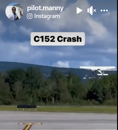

red750 Posted August 11, 2023 Share Posted August 11, 2023 EMMANUEL • AVIATOR • SCHOLAR • ATHLETE on Reels | pilot.manny ·... WWW.FACEBOOK.COM 394K views, 4.9K likes, 241 comments, 168 shares, Facebook Reels from EMMANUEL • AVIATOR • SCHOLAR • ATHLETE. pilot.manny · Original audio Link to comment Share on other sites More sharing options...
onetrack Posted August 11, 2023 Share Posted August 11, 2023 Control lock problem? He went virtually straight up, that's not a normal takeoff climb rate. Link to comment Share on other sites More sharing options...
turboplanner Posted August 11, 2023 Share Posted August 11, 2023 At this point it looks like he may have started his take-off run too far down the runway, or took his time opening the throttle etc, then it was too late to clear the trees, or he may have panicked and tried too hard to clear the trees. He could have just turned slightly right and headed for those buildings on the far ridge. The height of the trees cal roughly be scaled against the compressed length of the aircraft where it finishes up. They may not have been in compliance for an ALA. 1 Link to comment Share on other sites More sharing options...
Thruster88 Posted August 11, 2023 Share Posted August 11, 2023 Given the amount of flap it is most likely a messed up go round. 1 Link to comment Share on other sites More sharing options...
RFguy Posted August 11, 2023 Share Posted August 11, 2023 (edited) hard to see how close the trees were. Better to run into the trees than stall. Assuming not a control surface failure (remote) : What's missing here is the basics- not pushing the nose down if the airspeed is critical... no matter what the circumstance. Must keep aircraft flying. no matter what . If time, turn the fuel and the master off. and cover your face with your hands as you go into the trees. Nothing much to learn here .. IMO..... (control surface failure aside) Edited August 11, 2023 by RFguy Link to comment Share on other sites More sharing options...
Bosi72 Posted August 11, 2023 Share Posted August 11, 2023 The aerodrome, taxiway markings are telling it is likely a certified aerodrome, which must satisfy legal requirements (eg obstacle clearance..). The trees in the background are optical illusion. I suspect the seat locking pin broke (not every cessna has AD implemented), or simply a pilot error.. I expect it will be covered on one of the youtube channels.. 2 Link to comment Share on other sites More sharing options...
turboplanner Posted August 11, 2023 Share Posted August 11, 2023 Just now, Bosi72 said: The aerodrome, taxiway markings are telling it is likely a certified aerodrome, which must satisfy legal requirements (eg obstacle clearance..). The trees in the background are optical illusion. I suspect the seat locking pin broke (not every cessna has AD implemented), or simply a pilot error.. I expect it will be covered on one of the youtube channels.. Does anyone know whether the 152 uses the same pin locking seat slide method as the 172? 1 Link to comment Share on other sites More sharing options...
Rotorwork Posted August 11, 2023 Share Posted August 11, 2023 From ASN https://aviation-safety.net/wikibase/343072 1 Link to comment Share on other sites More sharing options...
Bosi72 Posted August 12, 2023 Share Posted August 12, 2023 2 hours ago, turboplanner said: Does anyone know whether the 152 uses the same pin locking seat slide method as the 172? looking same to me, although seat is closer to floor. https://www.wagaero.com/airframe-parts/cabin-components/seat-rails-rollers-stops/seat-rails/cessna-150l-m-a150l-m-152-all-seat-rail-inboard-faa-pma.html 1 1 Link to comment Share on other sites More sharing options...
turboplanner Posted August 12, 2023 Share Posted August 12, 2023 58 minutes ago, Bosi72 said: looking same to me, although seat is closer to floor. https://www.wagaero.com/airframe-parts/cabin-components/seat-rails-rollers-stops/seat-rails/cessna-150l-m-a150l-m-152-all-seat-rail-inboard-faa-pma.html So definitely wouldn't rule that out, along with onetrack's control locks. Reported serious injuries so with luck there'll be a pilot to talk about it, but we'll probably have to wait for the Transportation Safety Board to tell us. 1 Link to comment Share on other sites More sharing options...
turboplanner Posted August 12, 2023 Share Posted August 12, 2023 5 hours ago, RFguy said: hard to see how close the trees were. Better to run into the trees than stall. Assuming not a control surface failure (remote) : What's missing here is the basics- not pushing the nose down if the airspeed is critical... no matter what the circumstance. Must keep aircraft flying. no matter what . If time, turn the fuel and the master off. and cover your face with your hands as you go into the trees. Nothing much to learn here .. IMO..... (control surface failure aside) Plenty to learn if you want to avoid it; I've been approaching that situation twice, both times from mistakes. 1 Link to comment Share on other sites More sharing options...
