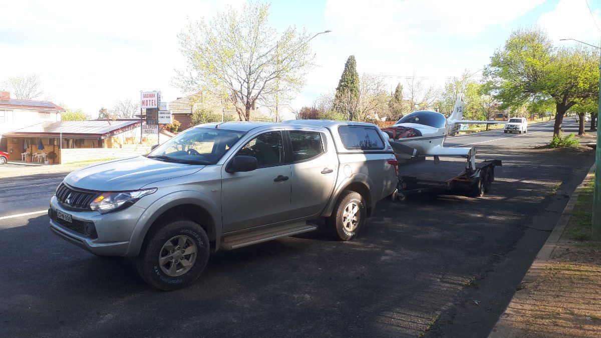

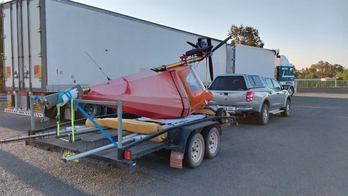

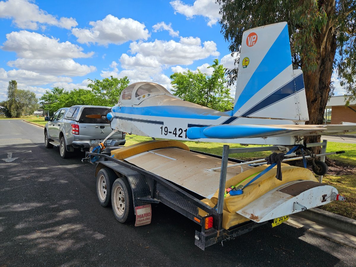

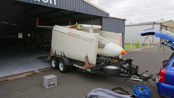

Hi Truster 88,
Observations:
First photo - Handy being able to remove the wing skins for transport.
Second 19-421. Seems to have only one wing. Empennage not secured
Last - no wings at all. Empennage not secured
Completed fuselage is possibly the easiest "bit" (aeronautical term) to secure & transport.
Partially completed aircraft (lots of fragile bits) may be the hardest, depending on what the build stage is.
Wings are the hardest part of a complete aircraft to pack safely/securely due to size, shape, vulnerable skin (in most instances), lack of on wing tie options. Purpose built cradles, conforming to that wing aerofoil, are possibly the best solution but not always available. Making a flat to tray  "sandwich" polystyrene sheets/wing polly sheet/wing polly sheet (accommodating pitot tube) works quite well but needs to be monitored for load shift. In both systems elevator/flap are vulnerable and must be well secured .

Wings are easy to secure and protect.  Done it several times. T 88 has the tail feathers removed because of their width. I have moved my thruster with the tail feathers on but they are 2.6 mt across . I never got any attention from the cops apart from questions about the aircraft.  Don't tow an aircraft anywhere if your not prepared to talk to people because they create a lot of interest.  I came out of Macca's at Euroa and there were people lined up to sit in it and take photos.

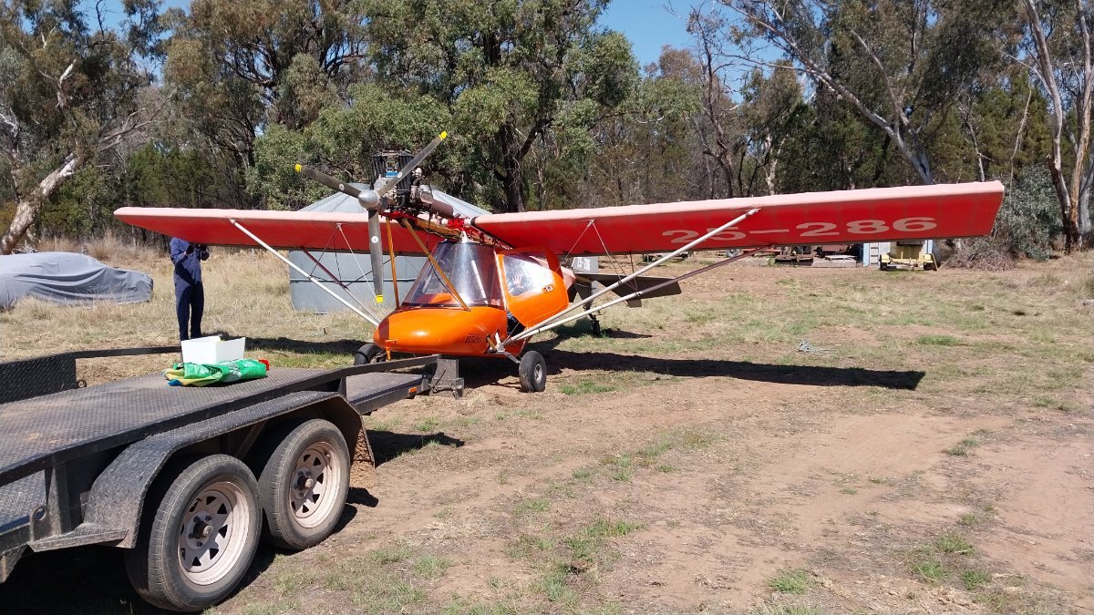

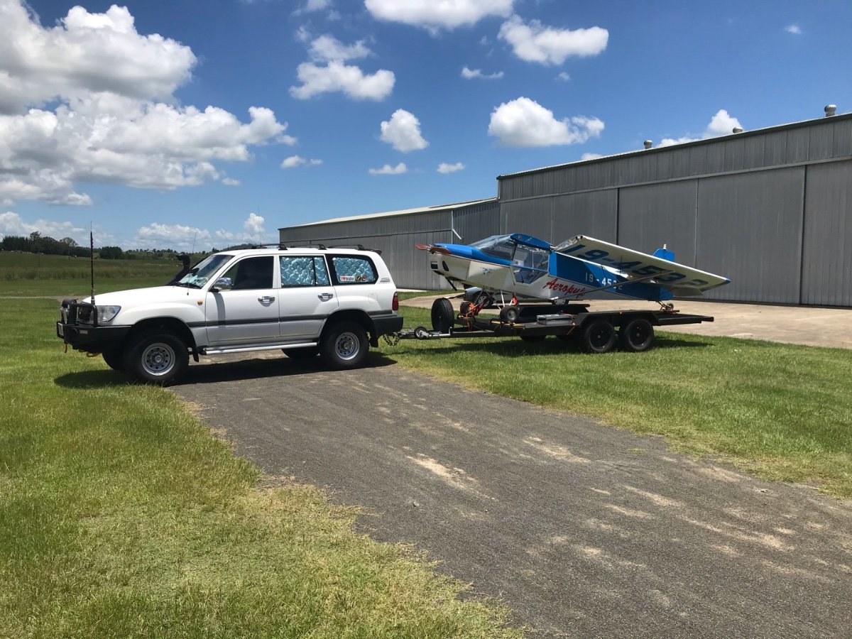

Just beg borrow or steal flatbed trailer. Its easy enough. I bought Mabel from western mid NSW and bought her all the way to north of Brisbane on a trailer. Wasnt a drama at all. Just took her this week down to the hangar for final assembly when I can get a chance to work on her.She has been a long project to totally rebuild from scratch
