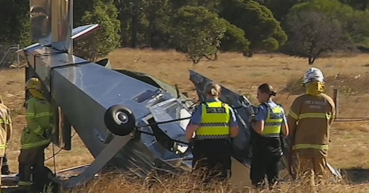

Marty_d Posted March 1 Share Posted March 1 Hope he makes it. "Critical" is not good. Zenith CH-750 by the looks of it. Might be a 701 with added windows aft of the door. Looks like polished bare aluminium which is unusual for these slab sided planes. Wonder if it was test flying before painting? 3 1 Link to comment Share on other sites More sharing options...

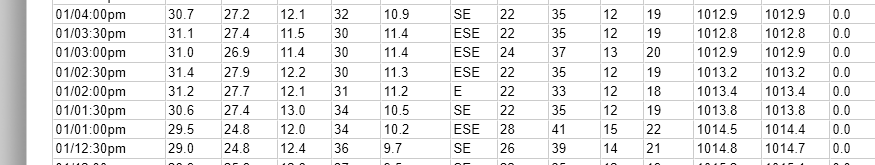

onetrack Posted March 2 Share Posted March 2 The wind has been screaming from the SE for the last 24 hrs, as a big high pressure system moves into the Bight, and it's coming up against a big trough running N-S through the Western part of W.A., and a low pressure system N of Geraldton. I was in the Wheatbelt yesterday, and the wind was relentless, strong and gusty - with some vicious gusts to probably 30kts. The record shows the wind from the SE at Bunbury at 3:00PM was at 13kts, and gusting to 20kts. I wouldn't be surprised if a vicious gust was behind this upset. 2 2 1 Link to comment Share on other sites More sharing options...

walrus Posted March 3 Share Posted March 3 Correction, not a Zenith 750. Maybe a Savannah? I hope the pilot recovers. Link to comment Share on other sites More sharing options...
Marty_d Posted March 3 Share Posted March 3 I think it's a Zenith rather than a Sav, because it's got the "inverted airfoil" HS, and the all-flying rudder. Actually looking at the shape of the windows aft of the door, and the fact that it's VH registered, I reckon it might be a CH-801 (4 seat model). Link to comment Share on other sites More sharing options...
Marty_d Posted March 4 Share Posted March 4 Something's wrong there. It's definitely not a Cruzer because the tail surfaces are all wrong for that. Plus the VH register shows it as being 700kg MTOW where the Cruzer is 599kg. CH-801 - note the tail surfaces and windows aft of the door 750 Cruzer - standard fin and rudder, symetrical HS, curved rear window Crashed a/c -same flying rudder, inverted airfoil HS and double rectangular windows as the 801 2 Link to comment Share on other sites More sharing options...
walrus Posted March 4 Share Posted March 4 The window arrangement does not look like a Zenith 750 Cruzer or STOL, neither does the door, which on a 750 is a one piece bubble. The Cruzer doesn't have an inverted stabiliser and the 750 STOL doesn't have those tips on the stabiliser. Neither of them comes standard with hub caps. Both the Cruzer and 750 STOL are good for 650 kg MTOW. Perhaps it is a 701, 801, Savannah or some sort or some modified combination. It appears that the aircraft was only registered a month ago, so that suggests the pilot didn't have much time on type. The behavior of some light aircraft in a strong crosswind can be challenging. You need to remember the rules for control positions when taxiing and be very, very careful to ensure that the upwind wing never gets too high an angle of attack. If it is a ZEenith type, the full span flaperons get quite heavy when drooped as flaps and while they are very effective you have to be ready to apply some muscle make them work and to keep that into wind wing down and under control. In any case I hope the pilot pulls through. 1 Link to comment Share on other sites More sharing options...
