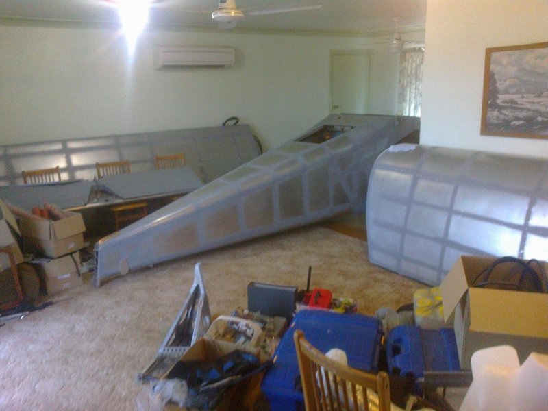

Still think you could build the rudder, elevator stabilizer and fin, flaps and ailerons in the lounge room while you are waiting to finish the shed! It will help your wife improve her adaptability and coping strategies. To be fair I used my mother's lounge room not my wife's and she had just moved to town to retire. So I was really only making it so she wouldn't change her mind and want to come back.
