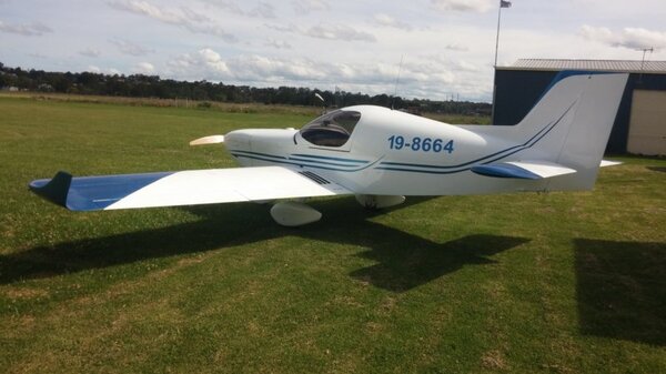

Yep hot. My canopy has been painted overhead which reduces the direct sun on your head. A better fix would have been vinyl wrap which could be removed or re-positioned unlike paint.
