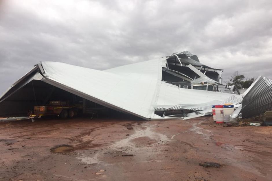

Kgwilson is correct on the damage that can be inflicted by tornado-like events embedded in storms - which are a totally different event, to just constant strong winds.
Often, "mini-tornadoes" accompany sudden and violent storms, which are usually associated with the approach, or passing, of strong cold fronts. Mini-tornadoes can also suddenly develop from severe thunderstorm conditions in Summer.
I have seen the result of many mini-tornado events. They are usually confined to narrow strips, generally ranging from a couple of hundred metres wide, to half a kilometre wide, and rarely more than about 2 or 3 kms long.
I have seen numbers of substantial farm sheds, and farm machinery, utterly destroyed by these events. I have seen violent destruction of heavy native vegetation, including large trees.
The worst mini-tornado result I have ever seen, was South of Higginsville, W.A. in July 1975. Whilst living on my gold mine at Higginsville, I endured a very frightening July night with a very strong and violent cold front passing through, with sustained winds in the region of 80-110kmh, all night.
In the morning, I drove down the Coolgardie-Norseman Road to Norseman, and about 10kms S of Higginsville, I encountered the result of a mini-tornado that had crossed the highway - that was more like an American, full-size tornado.
The area was native W.A. Goldfields vegetation, with substantial amounts of trees - Gimlet, Goldfields Blackbutt, and other large trees such as Salmon Gums, up to 20-25M high.
A mini-tornado had developed in the front during the night, and it had cut a path of destruction through the trees and native vegetation, that resembled a scene similar to two bulldozers dragging a heavy clearing chain through the countryside.
Large trees were completely twisted off at heights of a metre to two metres off the ground, and virtually all the vegetation was flattened over a width of about 400-500 metres, and for a total distance of about 2 kms.
I have never ever encountered such frightening destruction and the power in a tornado-like event, before or since - but this destructive event indicated what is possible when the right weather conditions prevail.
As KGW says, you need to be alert to such conditions possibly developing, and ensure you and your aircraft are well away from these particularly destructive event/s.
A farmer friends machinery shed, after a mini-tornado hit -
