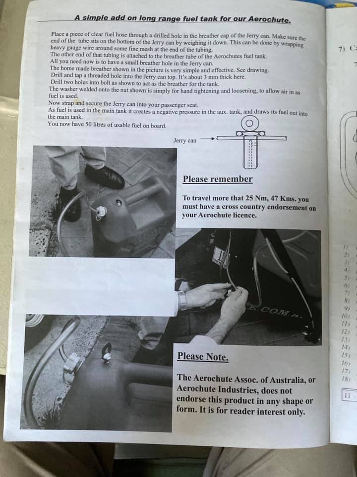

Many years ago I needed extra fuel for a long trip. Not a jab, but what I did was carry a 20l container in the fuse with a fuel line from the fuel tank breather to the bottom of the container plus a vent line from the container to a vent point outside. That meant that at start up fuel was drawn from the container through the fuel tank and used. The vent to the container acted to vent the main tank when the fuel emptied from the container. It just needed a spevial cap for the container with the two fuel lines. It worked well with oniy a small amount of fuel left in the container.

KISS at its best - well done Yenn.
Not sure that I would be game to use your system - prefer to have a pump delivering the aux fuel to the main tank when I turn the switch on.
The beauty of a bladder (like the Turtle-Pack) is that no vent is needed - just have to have a transfer pump and of course the bladder can be folded away when empty, something a rigid entertainer cant do.
Used on PPC Aerochute, I have used on seat beside me used as described by Yenn, worked a treat (same level as main tank). Fuel cap has 'O' ring so sealed system, if fuel cap not airtight would not work
