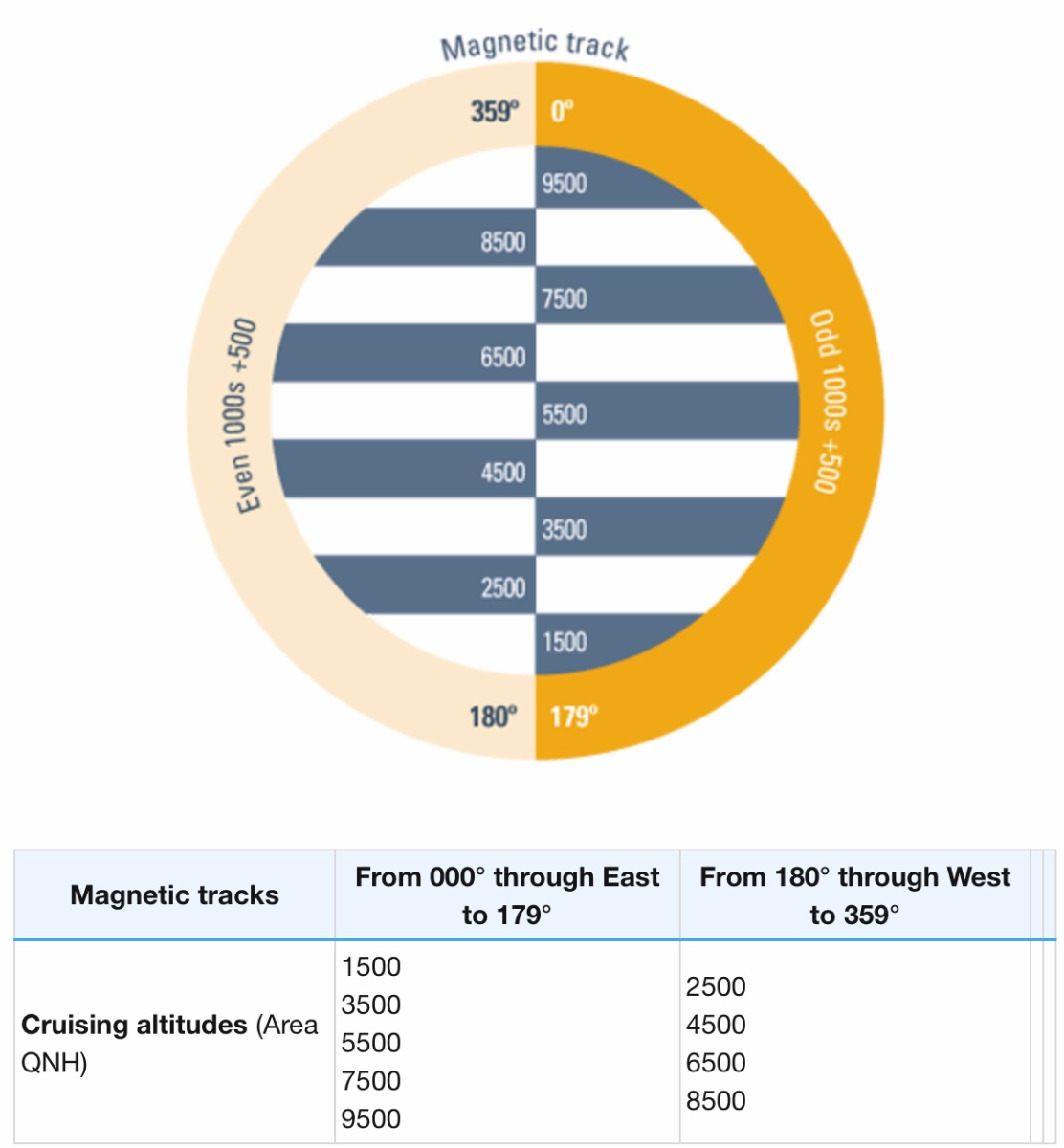

Run your wheels along the ground and note the alt reading and add 1500 to it.  I give UP. What's 5 hours got to do with it?   Nev
Nothing - Was just thinking about long navs over various elevations as apposed flying around your home AD.
Link to post
Well I could be rather safe by flying on roadmaps and keeping my 1500ft.
Me following roads will mean no one is stupid as me, and I won’t crash into anyone:-)
By the way, I can chuck this out the window under the new proposal.
Link to post
Yep!  It's a head scratcher.
So what happens when a few pilots are flying between ADs.  For example, many many many pilots simply follow the magenta line.   So let's pic 2 ADs..... We will call them Simpleville and Dopeyville.    These 2 ADs are popular and the route between them is a popular nav route on the way to other places.
How do pilots safely separate?  If you have even 2 or 3 aircraft travelling between these 2 ADs, remaining between 500ft AGL and 1500ft AGL how do they ensure they are not head on?  Everyone will basically sit on 1000ft.  Then what?
It's doing my head in!
