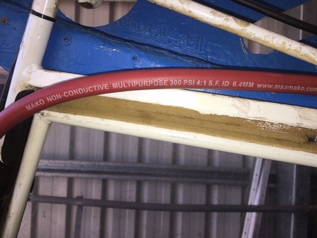

Just had my Rotax 5 year rubber replacement done,  does this also include all aircraft fuel lines too?
only some of mine it appears were replaced with this hose?
Not sure IF is the correct hose?
Reason I ask is I had same type 500psi rated hose on my old ‘77 Landcruiser that runs 98 unleaded.
It lasted 18 months and ruptured near the carby, nearly causing an engine bay fire.
so I am wondering IF I should redo my Rotax dual lines?

All engine related rubber should be replaced at the 5 year interval. This includes all fuel lines/hoses to/ from tanks.
Cant comment on the illustrated hose - The claimed pressure rating is way more than adequate but that has little to do with is suitability as a Rotax aircraft engine hose.
I use Gates products for coolant and fuel. I prefer the Fuel Injection (FI) hose to the regular carburetor grade. Both are acceptable.  The FI has a higher heat/fire rating and a lower permiability but does cost more (only a few dollars extra to do my whole system). I also prefer the FI hose clamps as they appear to give a more even 360 pressure compared with a regular worm drive hose clamp.
Gates products are available through your local Repco auto store.

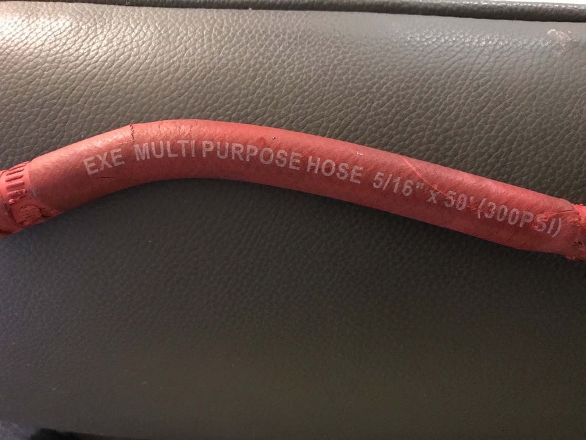

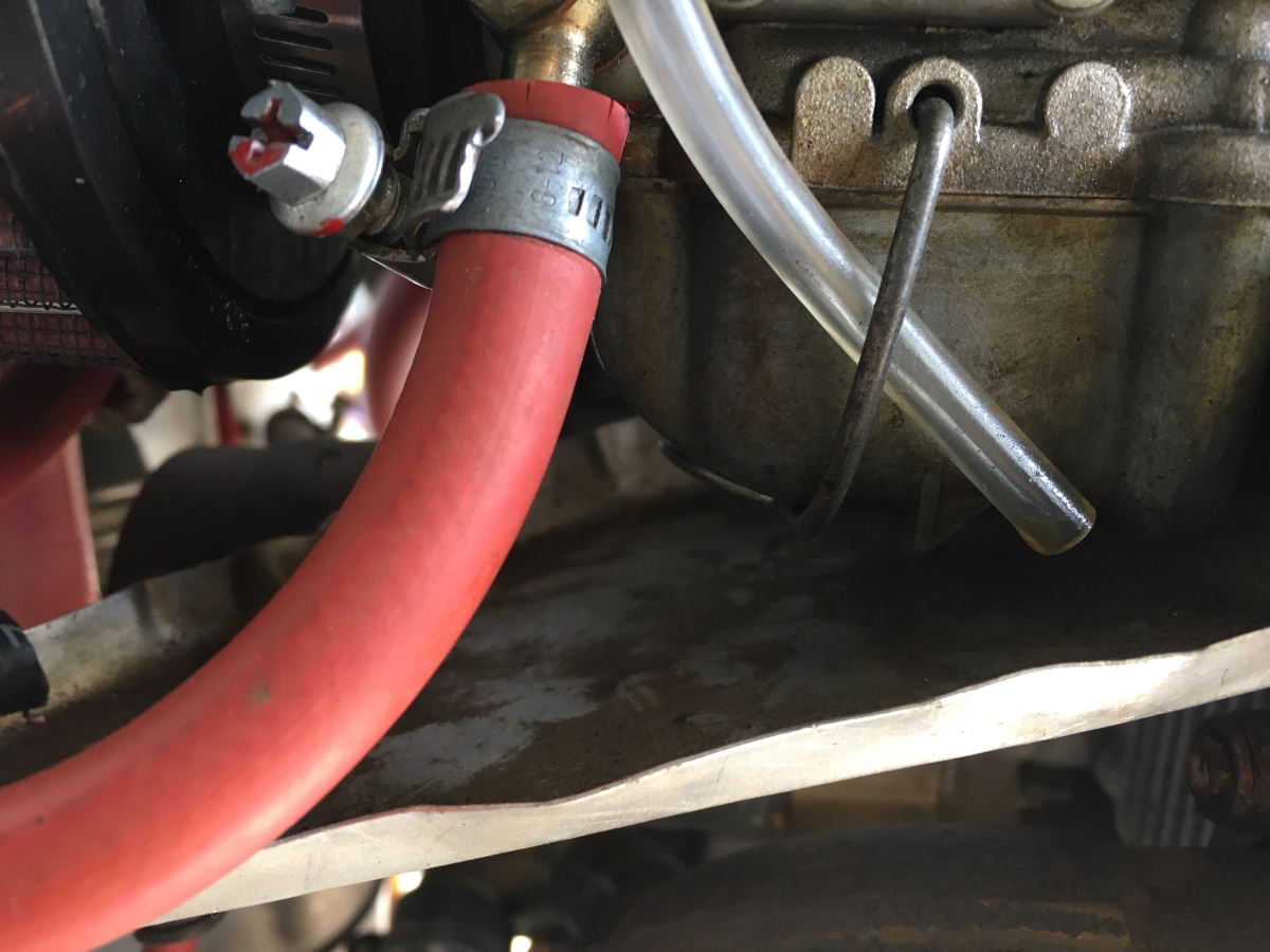

I am about to redo my 5 year rubber replacement after the LAME used fuel line that  is junk and has started to crack near the hose clamps after 3 months..  He left the bowl clip loose and drain tube hanging.
..0ABA79BC-8454-44D0-854A-D8ACD64CA104.thumb.jpeg.1ee8315b8d377d00b6c6bdeaa05e06c6.jpeg
This red fuel line (below) lasted 18 months on my 77 Petrol Landcruiser, then ruptures spraying fuel over the engine.
Jackc, wow, LAME leaving float bowls loose (I see the non vertical clip in the top pic), is quite serious....I’ve always thought it a bit ironic how some people in GA frown at RAA owners doing their own maintenance, because you hear of a lot of LAME horror stories. Yes, no doubt horror stories on both sides....but a mate recently had his Eurofox serviced ($$$$) flying back, oil temp was higher than normal, on landing, found the oil rad flap had not been re-connected. Previous owner of my Gazelle sold it because it was costing too much to maintain, I saw one receipt. Total was for around $3000, of that only $60 was for parts, the rest was labour. Now not saying that wasn’t legit...but it’s great to be able to do a lot of your own maintenance!
That was just the start of it......bent undercarriage axle,  unequal undercarriage leg fitted for a ground loop repair.......the list goes on.
No problem for me, like everything in my life I will just fix it all and I guarantee any LAME won’t find a fault, anywhere.

I confess, I misused the loose float bowl (focused in on the hose) so well done F10 - this is definitely the sort of avoidable error that may cause a fire -  far more so than correctly fitted fuel hoses.
I would never use anything from Supercheap on an aircraft, because Supercheap focus 100% on the cheapest products they can find, to produce the maximum profit.
There's a lot of rubbishy rubber products that come out of Malaysia, Indonesia and China, that Supercheap mostly specialise in. If you want quality in rubber components, you use Gates products, and Gates Green Stripe where possible.
Anything designed for Marine use normally has superior quality in construction style and materials.
Rubber components are the weak link in every engine system. Anything you can do to reduce the amount of rubber in an aircraft is going to appreciably increase that aircrafts safety level.
If it was my choice, and my aircraft (and I don't own an aircraft), I'd be choosing to eliminate as many rubber/rubberised hoses, as I possibly could.
Any hose that is red or yellow coloured has a short life, due to more rapid and more intense UV absorption. Green-coloured hose has the longest life, due to minimal UV absorption.
Those open slotted hose clamps sure do damage hoses, particularly if overtightened. These were apparently on a motor vehicle, but have no place on an aircraft engine..... Bob
Al my red hose and worm drive clamps are going in the bin......and I have lots of fire sleeving to do as well.......
