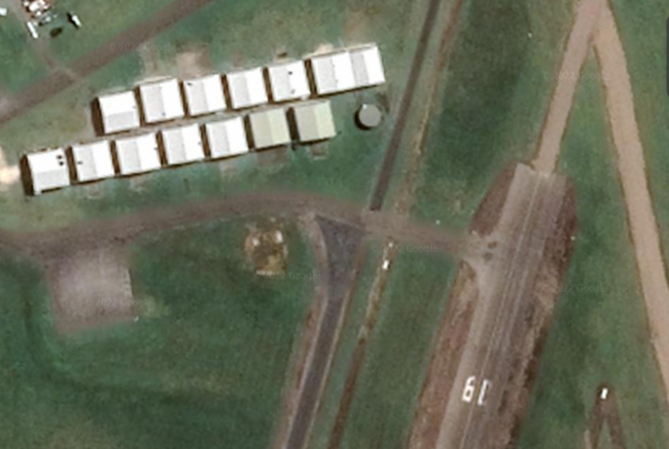

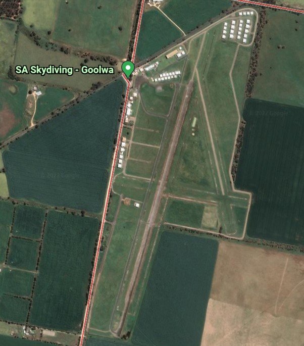

RossK Posted January 28, 2022 Share Posted January 28, 2022 When you read the report and look at the position of the hangar relative to the runway, it's hard not to think that this was a failed go around. When you pile on full power the nose is going to pitch up, probably beyond the critical angle if you don't control it ("not enough lift") and it's going to pull to the left ("veered from the end of the runway"). The impact site is level with the end of the runway 70m off centre line, so the veering must have happend well before then. 1 Link to comment Share on other sites More sharing options...

turboplanner Posted January 28, 2022 Share Posted January 28, 2022 Runway layout Link to comment Share on other sites More sharing options...
