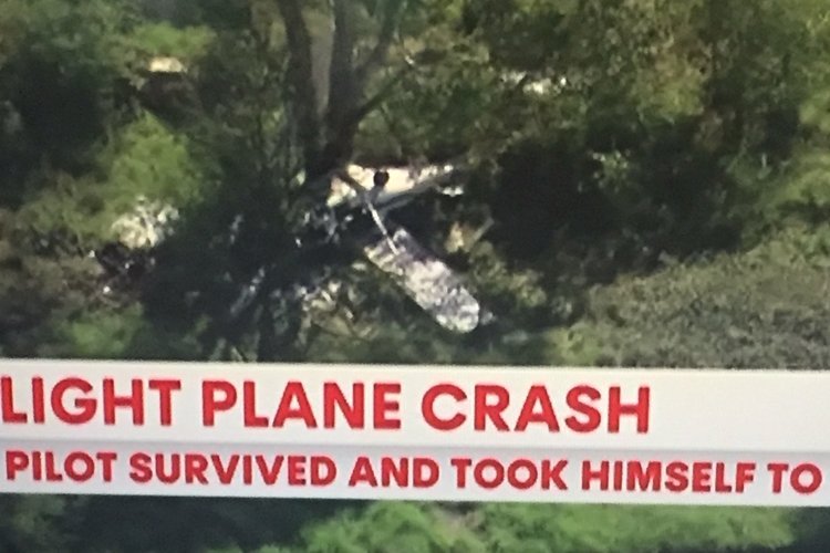

red750 Posted March 30, 2023 Share Posted March 30, 2023 A report of a light plane crash, with the location given as 'near Sydney' today. From the screenprint from Ch 7 News below, it appears to be a Jabiru. The pilot is reported to have driven himself to hospital, his passenger was uninjured. No further details on the 4.00 pm news. 3 Link to comment Share on other sites More sharing options...

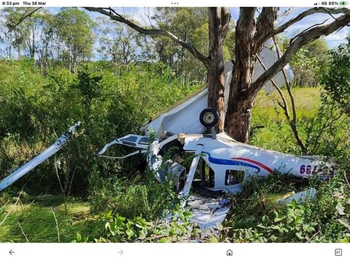

trailer Posted March 30, 2023 Share Posted March 30, 2023 (edited) Looks like an early model jab. Did well to get out. Edited March 30, 2023 by trailer 1 Link to comment Share on other sites More sharing options...

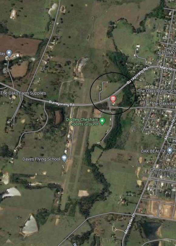

kgwilson Posted March 30, 2023 Share Posted March 30, 2023 (edited) The aerial shot from the ABC News showed the crash site right next the the end of the runway. That may be the runway in the upper right of the photo. Another excellent example of the strenght of the Jabiru cabin. It will be intersting to find out what happened. Edited March 30, 2023 by kgwilson 2 1 Link to comment Share on other sites More sharing options...

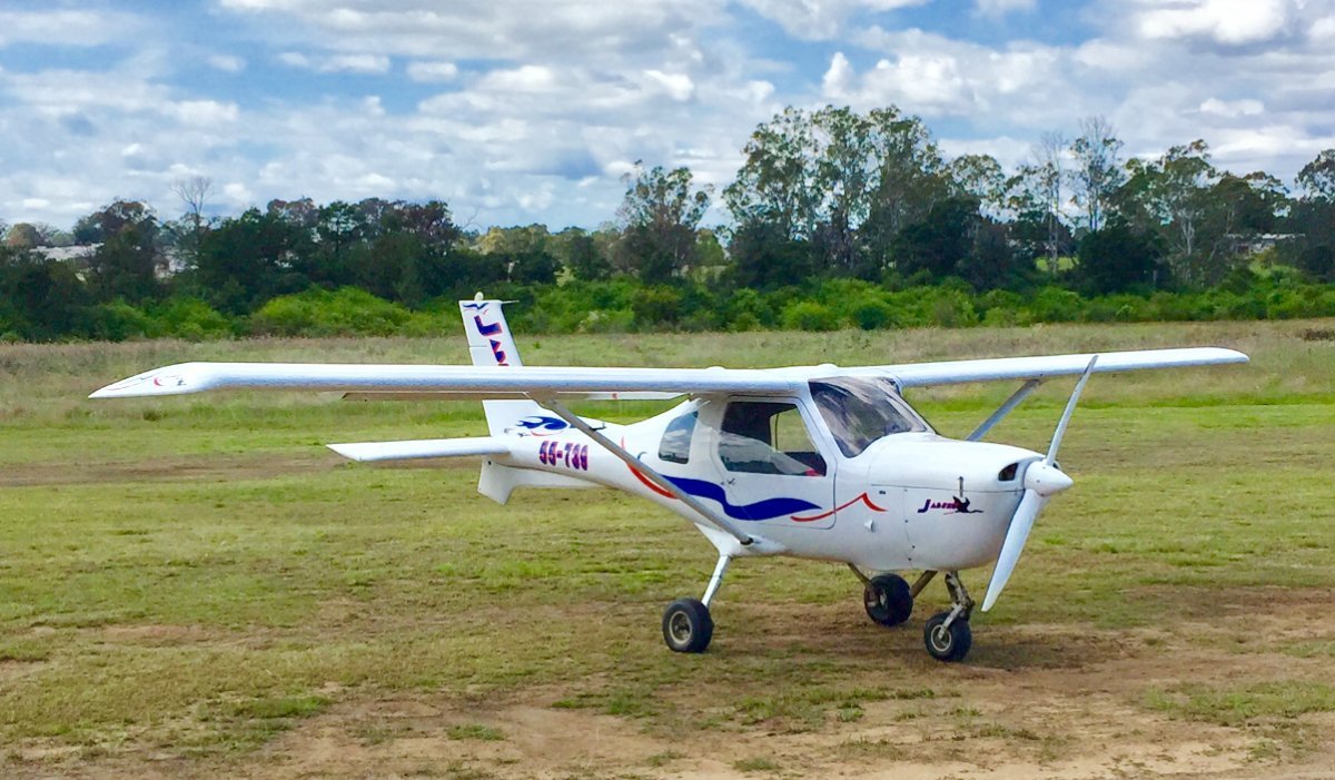

planedriver Posted March 30, 2023 Share Posted March 30, 2023 That's so sad!. Here's a photo I took recently when it was in better shape. Unfortunately this is the 2nd time this little Jabby has met up with a tree, but fortunately all on board survived pretty much unscathed, which is yet another testimonial of the strength of Jabiru airframes. The other occasion was an EFTO at Wedderburn in 2001 when it wound up in the trees that surround the airport. 1 1 Link to comment Share on other sites More sharing options...
kgwilson Posted March 31, 2023 Share Posted March 31, 2023 The latest damage has seen its flying days over I think. Maybe it's an optical illusion but the prop looks bigger than it should be. 1 1 Link to comment Share on other sites More sharing options...

kgwilson Posted March 31, 2023 Share Posted March 31, 2023 Too much money and a gung ho attitude is not a good combination for a budding pilot. And Yes the PIC is the Instructor. From Google Earth there seems to be a tree that overhangs the runway near the threshold on 18 L where the crash occurred. ERSA states "Tall trees in close proximity to THR of RWY 36 L/R and 18L" How they managed to drift to the right and hit the tree about 50 metres from the end of the runway should come out in the report. Straight ahead and off the end of the runway there are also trees but they appear not to be too tall & aiming between a couple (if possible) would be the best option to rip the wings off & absorb a lot of the energy. 1 1 2 Link to comment Share on other sites More sharing options...

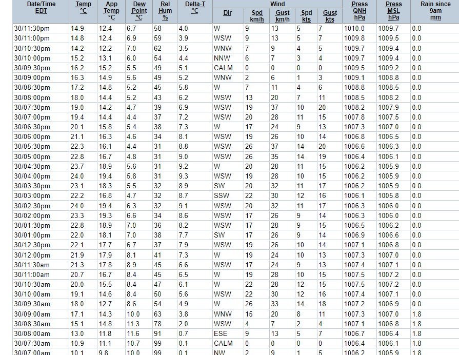

skippydiesel Posted April 1, 2023 Share Posted April 1, 2023 On the day of the accident, this aircraft had completed a flying lesson, . A second (very low hours) student got in & commenced circuit training, with instructor John. Active runway was 180 At The Oaks, wind was from the south west, variable & gusting (The Oaks frequently has weather conditions that differ to that of the nearest BOM/Camden) Don't know if it was the first touch & go, or after several but engine started to loose power on climb out . It appears likely that it just/almost made circuit altitude, prior to engine quitting. Speculation: I have no idea about the time span between loosing power/failing however it is known that John took over and attempted a, tail wind, return to the field (he must have judged he has sufficient height to do so). At the time of the accident, he would have been low and on late base, presumably going to make a low turn onto final, for a mid field touch down. lt is likely a gust (tail wind) hit just prior to turning final, effectively reducing air speed and increasing rate of decent - what could have been a successful landing, ended in the small tree on the western edge of the runway 360 threshold. I understand: No one knew of the accident, until John & student were spotted (by a pilot doing circuits) walking down the strip. John suffered injury to his nose & thumb - he has had an operation to "fix" the damage. His wife (not the ambulance) drove him to hospital - I wish him a speedy recovery. Student sustained a minor injury to one leg & declined medical assistance. Its awful when an accident occurs and it would have been better that the aircraft was not so badly damaged, however pilot & student literally walked away, which in my book is a good outcome. 3 1 1 4 1 Link to comment Share on other sites More sharing options...
