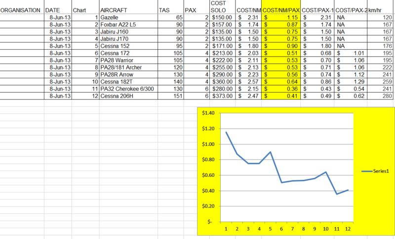

turboplanner Posted February 3, 2017 Posted February 3, 2017 Quote I plan on touring If this is what you are planning to do you are better off going GA. RA is better for pottering around, just enjoying flying for an hour or two here and there, going to the odd breakfast in the local area, but when you seriously commit to touring, the GA aircraft have the endurance and reliability, much less downtime ferrying jerry cans from various towns, the ability to fly longer kegs faster, and so make use of larger airports with more facilities, and provide the option of IFR training so you can get the aircraft back home within a weekend. While RA has a lower cost per hour, when you are flying an hour at a time, the figures come out differently when you are covering touring distances; the faster the aircraft the lower the hours for a given distance, and even within GA, if you are talking about regular touring, the optimum aircraft are up the range from the C172 abd Cherokee Warrior. Also, when you break down the costs per person touring, the more seats, the lower the cost. I did this spreadsheet comparison in 2013, and it more or less shows that if you just want to have a fly around the local area, a Gazelle is fine, but if you want to tour, the Cherokee 6 is a low cost aircraft per person. 1 2

Jabiru Phil Posted February 3, 2017 Posted February 3, 2017 Quote If this is what you are planning to do you are better off going GA.RA is better for pottering around, just enjoying flying for an hour or two here and there, going to the odd breakfast in the local area, but when you seriously commit to touring, the GA aircraft have the endurance and reliability, much less downtime ferrying jerry cans from various towns, the ability to fly longer kegs faster, and so make use of larger airports with more facilities, and provide the option of IFR training so you can get the aircraft back home within a weekend. While RA has a lower cost per hour, when you are flying an hour at a time, the figures come out differently when you are covering touring distances; the faster the aircraft the lower the hours for a given distance, and even within GA, if you are talking about regular touring, the optimum aircraft are up the range from the C172 abd Cherokee Warrior. Also, when you break down the costs per person touring, the more seats, the lower the cost. I did this spreadsheet comparison in 2013, and it more or less shows that if you just want to have a fly around the local area, a Gazelle is fine, but if you want to tour, the Cherokee 6 is a low cost aircraft per person. [ATTACH=full]48111[/ATTACH] Hi Yenn, Appreciate your posts but have to reply to your comments above We did a trip ex Victoria, NT centre, west coast WA and home via Kalgoolie, port Lincoln. I can tell you truly that the Jab 230 out performed fuel wise better than the C206, Warrior and Technam, and C 172. Fuel stops planning were mainly to satisfy them when we could have cut our flying time by heaps. I still have the log if interested further. Regards. 3

turboplanner Posted February 3, 2017 Posted February 3, 2017 Quote Hi Yenn,Appreciate your posts but have to reply to your comments above We did a trip ex Victoria, NT centre, west coast WA and home via Kalgoolie, port Lincoln. I can tell you truly that the Jab 230 out performed fuel wise better than the C206, Warrior and Technam, and C 172. Fuel stops planning were mainly to satisfy them when we could have cut our flying time by heaps. I still have the log if interested further. Regards. The figures are hire rates including fuel, so fuel economy for the aircraft is factored into them. The 230 would have a cost per nm per pax advantage over the 160 and 170 for the type of long trip you mentioned.
