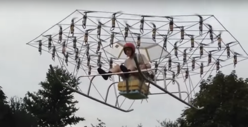

Garfly Posted February 15, 2017 Share Posted February 15, 2017 This guy could well afford to lose one ... (RAAus might need to rewrite the regs limiting aircraft to 60 engines. ;-) 1 Link to comment Share on other sites More sharing options...
kasper Posted February 16, 2017 Share Posted February 16, 2017 Joe Blogs builds a multi electric or jet engine, 95-10 and now requires an RA-Aus pilot certificate to fly it...Who is the current RA-Aus qualified multi electric or jet engine instructor???....Am I missing something here?Frank. And where is there a requirement for jet endorsement? Or twin endorsement? Last twin I flew was a Lazair with twin chainsaw engines. It was 95.10 and no particular drama. And that's the way it should be. Frankly fed up the back teeth with all the bullshit GA "endorsement" stuff galloping into RAAus. And it's not needed. If anyone could point to all the horrendous accidents and deaths that are airframe or configuration related them maybe I'd have sympathy with the direction of travel but it is not there and the overkill GA stuff is in my opinion both empire building and doing something to be seen to do something. Rant over 2 1 Link to comment Share on other sites More sharing options...
kasper Posted February 16, 2017 Share Posted February 16, 2017 This guy could well afford to lose one ... (RAAus might need to rewrite the regs limiting aircraft to 60 engines. ;-) [ATTACH=full]48517[/ATTACH] But that would have to go through the gyro group not RAAus ... it's got no wing area so doesn't fit within any of the CAOs RAAus look across. 1 Link to comment Share on other sites More sharing options...
facthunter Posted February 16, 2017 Share Posted February 16, 2017 A gyro flys with no engine power if required so perhaps it's rotary wing. Still supported by aerodynamic forces. Vectored thrust might be an appropriate category for heavier than air objects that occupy the sky relying directly on the engine(s) thrust to be able do that. . Nev Link to comment Share on other sites More sharing options...

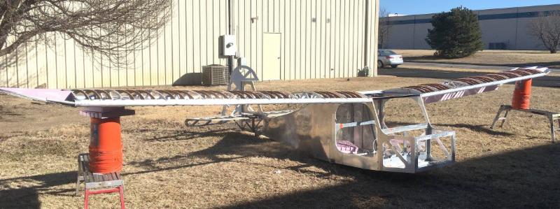

Litespeed Posted February 16, 2017 Share Posted February 16, 2017 Back to the Belite Skipper. Wow- what a cool use of alloy honeycomb, it must be getting cheap. He has managed to do a alloy aircraft at a amazing price and it looks like it will be strong and light. Add a cheap engine, some belite instruments and a dirt cheap aircraft for two. Any thoughts? 1 2 Link to comment Share on other sites More sharing options...

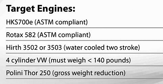

Garfly Posted February 16, 2017 Share Posted February 16, 2017 Here's a short vid of James Wiebe (Mr.Belite) constructing one of his Pippers (not Skipper BTW ;-) More construction stuff on Facebook (which non-members can access) Belite Aircraft | Facebook Design goals *Conventional aerodynamic design *Side by side seating *Designed from a clean sheet in CAD and state of the art build technologies *Very quick build time with highly accurate parts and high strength modern materials *Classic look and fun to fly *Good short field performance *Rugged landing gear *Taildragger or tricycle gear configuration *Primary structure of aluminum with lightweight honeycomb *380 pound empty weight (with 2 stroke engine and normal instrumentation) *430 pound empty weight (with 4 stroke engine) *850 pound gross weight *Up to 65HP engine* 1 Link to comment Share on other sites More sharing options...
