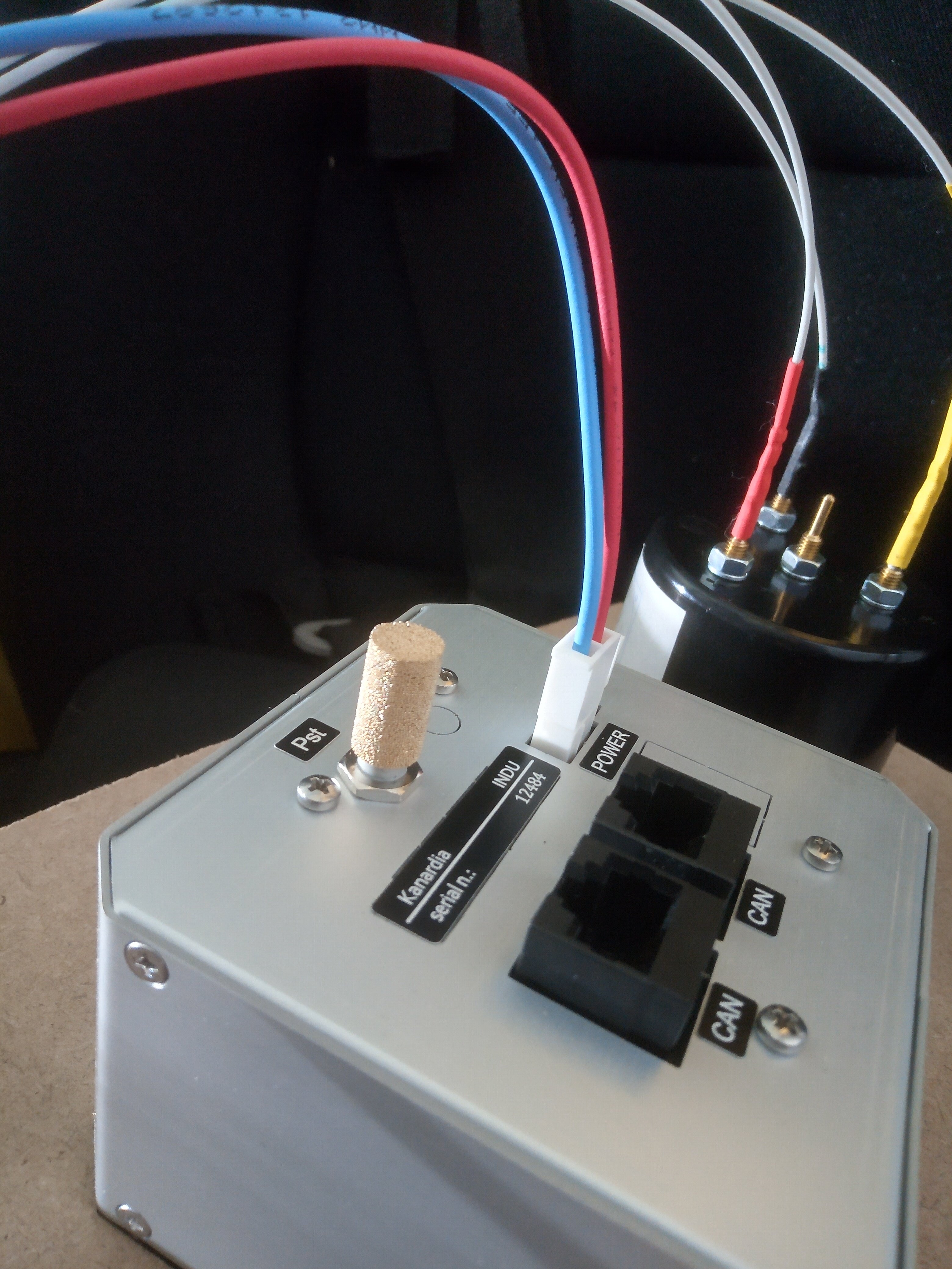

facthunter Posted June 5, 2020 Share Posted June 5, 2020 Use fine wire mesh in brass or buy a lawn mower fuel tap filter. Most cabins run a below ambient pressure which gets more so as you go faster. In an 8o k cruise plane you probably get away with an internal vent. It's the fail/default position for the flush vent which is usually duplicated on both sides and interconnected. Nev 1 Link to comment Share on other sites More sharing options...

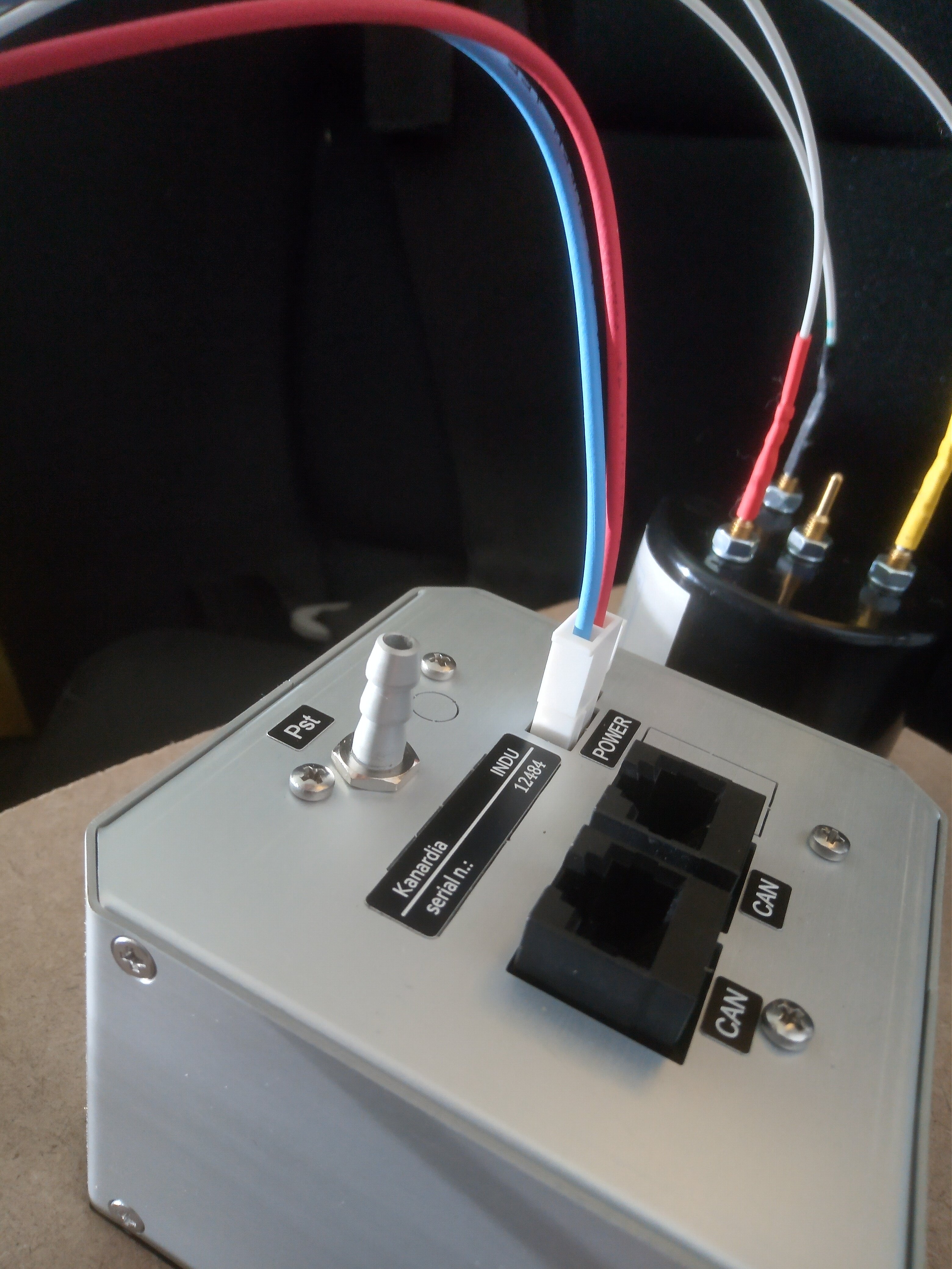

danny_galaga Posted June 10, 2020 Author Share Posted June 10, 2020 Use fine wire mesh in brass or buy a lawn mower fuel tap filter. You're a genius! Spot the difference ? 1 Link to comment Share on other sites More sharing options...
M61A1 Posted June 10, 2020 Share Posted June 10, 2020 You're a genius! Spot the difference ? Perfect... Link to comment Share on other sites More sharing options...
