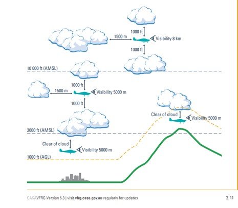

You don't have those instruments, but today's flight rules which require a minimum forward distance from cloud give you plenty of time to make a VFR turnaround, and that's way better than struggling out in marginal conditions and perhaps losing control, or your sense of direction to lower ground.
Prior to that the primary regulation was a minimum distance standard to cloud above you. Where that fell short was when the weather pattern was misty and the cloud was solid above you. You were already in "cloud" but you could see a couple of Nm ahead but you were really flying into the gradient, and if you didn't turn around fast enough you were in cloud. I've asked several times over the years for exerienced pilots to tell us what the Net Forecast would be for that condition or how to identify it, but there has never been an answer, so it's clearly a matter of being in the wrong place at the wrong time.

Having experienced that, would you agree that the longer perspective of the 5km and 8 km in the VFRG is an easier way to judge? WDVMC.jpg.4df6f1d80cd40a2ffba9a1edde4e0434.jpg
5km and 8km is visibility, not distance from cloud.
At 3000' distance to the horizon is about 100km, so 5km visibility is very poor. Technically VMC, but it wouldn't feel like it.

6 minutes ago, RFguy said:
5km/8km visibility - that I think would depend on the features on the ground . and features on the horizon .... A bit of haze dust in the air I find radically changes perceptions.
Aro I think I can tell 5km or 50km , but not much vernier in between.
5km visibility is thorough the air, not clearance from cloud. At 5km visibility you can't see the ground, terrain features, mountains etc. 5km away.
Yes ARO , I get that.    Generally if I am flying in condix where vis is less than 5km, I'm probably just poking around near the home aerodrome, with  SHWR VCNY,
5km is like 3nm, and about the size of Cowra AD outer boundaries.
In those cases you are probably barely able to see the base leg region from crosswind leg  (necessitating reduced height circuits).
That's pretty damn obvious.
