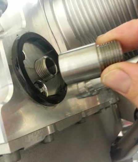

turboplanner Posted July 17, 2022 Posted July 17, 2022 The issue is (a) If the design is for the filter to seat as it normally does on the block seal, then the most likely cause is night correctly seating and tightening of the filter. (b) Go back about four posts and there's a photo of a nipple which appears to screw on to the block thread; so the filter if screwed on to the nipple is not going to seat on the block. Just basd on the photo, the filter when screwed on the engine is sitting in mid air so some component is missing, and it may be that this component is unsuitable to the simple screw on attachment method we use for spin in filters, in which case the issue may optentially apply to every engine with a nipple.

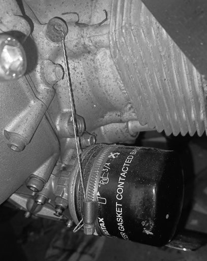

Old Koreelah Posted July 17, 2022 Posted July 17, 2022 After hand-tightening a new filter I always fitted a hose clamp around the filter body, then lock-wired it to a sump stud. After a well-qualified person called that overkill, I stopped doing it. Maybe I should go back to my old habit. 1 1
onetrack Posted July 17, 2022 Posted July 17, 2022 Every other threaded fastener of importance is either lockwired or secured with some other form of fastening, so why would you leave an important item such as the engine oil filter on a unsecured thread? 2
Kyle Communications Posted July 17, 2022 Posted July 17, 2022 I put a SS clamp..wormdrive one and just wire lock it to a bolt..it cant come off then 2
turboplanner Posted July 17, 2022 Posted July 17, 2022 A lot of posts relating to a conventional spin on, but did anyone see this photo posted by Thruster with someone holding the nipple and a seal on the block, so two threads and some (missing) component between the block and the filter body to provide a face for the filter seal and TWO threads to come loose? Source: Thruster88 2
facthunter Posted July 17, 2022 Posted July 17, 2022 The friction on the largish diameter seal is what holds it there. The specified extra turning decides the pressure on it. Mostly they are harder to undo than the force applied when tightening. There's no harm in a belt and bracers approach but a lose fitting thread and/or a split case will ruin your day.. Nev 1
turboplanner Posted July 17, 2022 Posted July 17, 2022 On 17/07/2022 at 6:07 AM, facthunter said: The friction on the largish diameter seal is what holds it there. The specified extra turning decides the pressure on it. Mostly they are harder to undo than the force applied when tightening. There's no harm in a belt and bracers approach but a lose fitting thread and/or a split case will ruin your day.. Nev Expand Have a look at the photo in the post directly above yours.
facthunter Posted July 17, 2022 Posted July 17, 2022 (edited) THAT seal ring should be enclosed so it can't be displaced by oil pressure. That situation is previously covered where the original stays in contact with the block, and you end up with 2 . This is the only failure that ever happened to me. At the factory the original engine is painted black and the filter seal stuck to the undried paint Everything being black it's not noticed so the filter should have been checked. Normally with an aeroplane the filter is cut open and examined for metal particles so that would have been picked up. My normal procedure is to put the old filter in the box the new one came out of.. . Nev Edited July 17, 2022 by facthunter 1
pmccarthy Posted July 17, 2022 Posted July 17, 2022 I have seen it argued that the risk of a hose clamp penetrating the filter case is greater than teh risk of theh filter coming loose. 1
