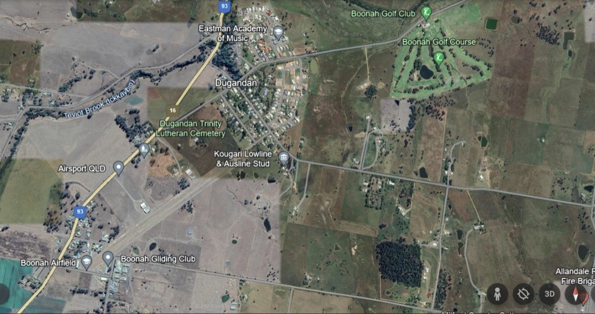

turboplanner Posted January 15 Share Posted January 15 The CFI was the 69 yo and the student/passenger was the 82 yo If you look at the Google Earth and take into account the location of the golf course, if they were landing it would be on 22 If you project out 45 degrees from the runway forthe base turn, the final turn would have been aproximately over the golf course entrance. This could be another pointer to a stall/spin in the turn. This link to a Beech Queen Air stall shows just how fast the stall occurs; I count 3 to 5 seconds and that's about the delay time for a pilot in command to make a reaction to an unexpected signal. (We've discussed reaction times on another thread here - 2/100 to 5/100 when waiting for a known signal from a measuring machine; 2 - 10 seconds with an unexpected signal wher you have to identify what is wrong) It's possible the passenger/student was flying and put on too much bank or too much backstick, but against this, they were making the Final turn from about the right place and directly on line for the runway, as against having overshot the turn. If it was trim runaway, it was at a point where whoever was flying was about at the end of making a deliberate turn. On the surface, they were at the right place at the right time. 2 Link to comment Share on other sites More sharing options...
