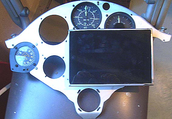

Dafydd Llewellyn Posted October 22, 2014 Share Posted October 22, 2014 What I get from this, is stick to lead-acid for the main aircraft battery; and where you have a low-power device such as an Ipad mini, it needs to be (i) in the shade, (ii) supplied with cooling air - and that may mean air that has been run past a freezer brick - and (iii) I'm going to put a temperature sensor on the back of the thing and see whether Don Ramsay's notion is correct. Link to comment Share on other sites More sharing options...

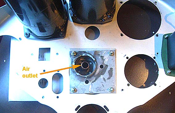

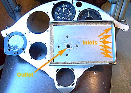

nomadpete Posted October 22, 2014 Share Posted October 22, 2014 Dafydd Can I suggest that you allow space within your metal encapsulation for the air to be drawn across the back of your IPAD? Logically, a charging source should reduce the heat generated within the device. Avoid the cheaper chargers. Also, avoid using a car type cigarette lighter socket. These are not reliable. Link to comment Share on other sites More sharing options...

Dafydd Llewellyn Posted October 22, 2014 Share Posted October 22, 2014 DafyddCan I suggest that you allow space within your metal encapsulation for the air to be drawn across the back of your IPAD? Logically, a charging source should reduce the heat generated within the device. Avoid the cheaper chargers. Also, avoid using a car type cigarette lighter socket. These are not reliable. That's how it's arranged - see photos . The installation is complicated by the fact that the panel you see here is shock-mounted behind a fascia in the aircraft that is structural; so the ipad tray has to be mounted on a stand-off from an existing instrument hole, such that when it's in the aircraft it stands about 6 mm proud of the fascia. As you can see, it is really a squeeze to accommodate it in the panel. In view of the upper temp limit of 35C, I may have to reverse the arrangement I intended and blow cold air onto the back of the ipad from what it shown as the outlet; and that supply may need to run through an insulated container holding a freezer brick. Glider cockpits can get very hot on the ground, so the ipad goes into the tray as the occupants climb aboard; but the cabin air temp may be too high to provide any useful cooling at low altitude. The lid of the tray is not shown in those pictures, but it opens to act as a shade hood. The 12 V charger I have is Bauhn 2.1 amp device; it seems to be the same Belkin charger, re-branded by ALDI, as Apple were recommending at the time. It's a cigarette lighter socket type, which I dislike, but I could not find anything more apposite at that time; maybe there's something better now (suggestions gratefully received). I'll be using a filter network to minimise the spikes going into it; the engine is a 582, and it's across a lead-acid battery. The ipad is a basic 16 Gb series one Ipad mini, and I use a BadElf Pro bluetooth GPS. The only application will be Ozrunways. Link to comment Share on other sites More sharing options...
