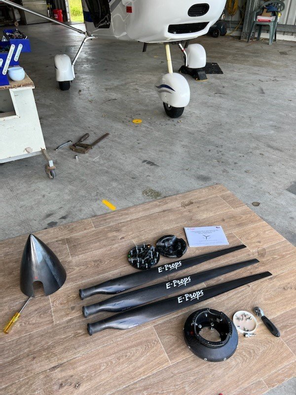

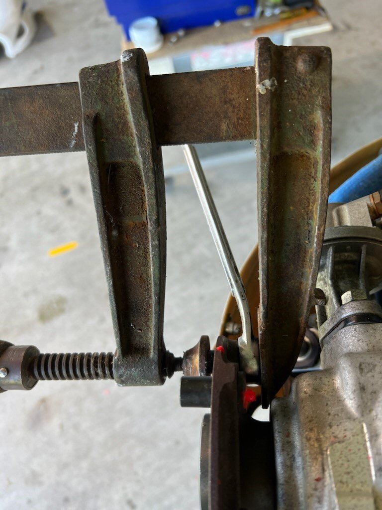

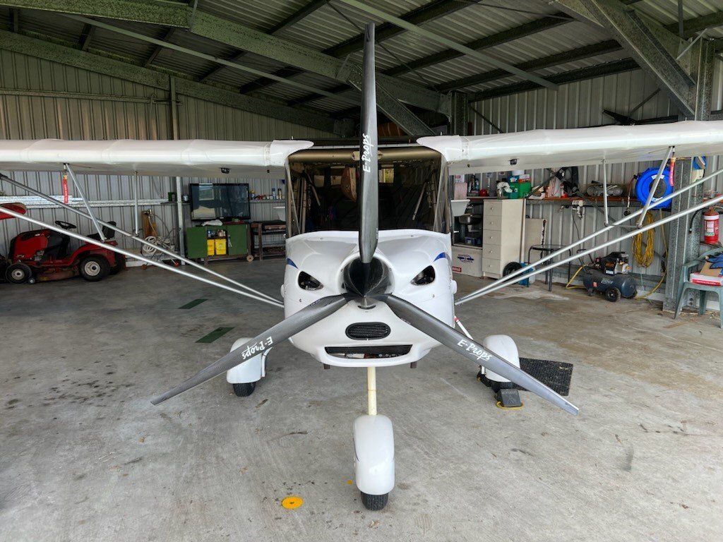

Blueadventures Posted April 18, 2022 Share Posted April 18, 2022 (edited) Fitted eprop onto the Rotax 912 ULS ready to torque and fly tomorrow all going well, rain to stay away. Needed to extract the prop lugs and used a 'C' clamp first then a sash clamp was best. Edited April 18, 2022 by Blueadventures 3 Link to comment Share on other sites More sharing options...
Thruster88 Posted April 18, 2022 Share Posted April 18, 2022 The alignment was off with the c clamp. These things are the difference between someone who struggles and another who makes it seem so simple in sport or tyre changing. Not have a go at you. 1 Link to comment Share on other sites More sharing options...
Blueadventures Posted April 18, 2022 Share Posted April 18, 2022 6 minutes ago, Thruster88 said: The alignment was off with the c clamp. These things are the difference between someone who struggles and another who makes it seem so simple in sport or tyre changing. Not have a go at you. All good T88; yep c clamp kept sliding off square. Was glad I took the sash clamp. The ring spanner end worked but an appropriate length of steel tube would be best to allow the exit of the lug. The eprop has epoxy lumps that pull into the prop flange so the prop lugs aren't required. Cheers. 1 Link to comment Share on other sites More sharing options...
Kyle Communications Posted April 18, 2022 Share Posted April 18, 2022 Mike..tie the aircraft down and set your pitch for 5500 wide open throttle on the ground. This is a good starting point. The ultimate aim is to get 5500rpm WOT in the air straight and level. Setting it like that on the ground will get you fairly close 1 Link to comment Share on other sites More sharing options...
Blueadventures Posted April 18, 2022 Share Posted April 18, 2022 Willdo, thanks. paperwork said 25* have 25.1 and need to torque up in morning. Had a tool missing to do the M8 nuts the other day. Link to comment Share on other sites More sharing options...
Kyle Communications Posted April 18, 2022 Share Posted April 18, 2022 Also make sure no more that 0.3 deg between any blades lower is better of course Just be aware to that dont jam the trottle on fast the prop tips can cavitate a little...just push it on firmly..also be aware that on landing you will not slow as fast as there isnt a huge paddle like before. Some do slightly adjust their landing approach but its no drama just a little different. I am keen to see your numbers at your std cruise rpm with it. Most get 5 kts increase some more just depends on the type of aircraft Link to comment Share on other sites More sharing options...
Blueadventures Posted April 18, 2022 Share Posted April 18, 2022 (edited) 29 minutes ago, Kyle Communications said: Also make sure no more that 0.3 deg between any blades lower is better of course Just be aware to that dont jam the trottle on fast the prop tips can cavitate a little...just push it on firmly..also be aware that on landing you will not slow as fast as there isnt a huge paddle like before. Some do slightly adjust their landing approach but its no drama just a little different. I am keen to see your numbers at your std cruise rpm with it. Most get 5 kts increase some more just depends on the type of aircraft Thanks Mark. Agree, within 0.1 at present. Also use the laser dot to verify the pitch comparison between the blades. Also I take 4 secs at least to bring on power at take , off and go arounds etc. My DUC prop was same re cavitation, their operation advice says not to jam onto full throttle quickly. I'm sure both DUC and E-Prop use similar tricky resins in the blade manufacturing. Thanks for heads up on landing roll. I'll advise my experience and most likely won't have too much info tomorrow as have to do some work at a house. And there is a heap of wind and rain coming from Wednesday; hence doing things first up in morning. Appreciate your information and advice. Edited April 18, 2022 by Blueadventures Link to comment Share on other sites More sharing options...
