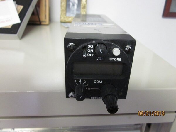

Have a look at the classifieds at www.seglflug.de. As Europe has abandoned 25kHz spacing there are many good radios coming out of gliders. I have installed 2 Becker 4201 at a cost of $3-400 each. They fit in a 21/4 hole.
I have XCom, works fine.
But Becker are good gear and the quote above would definitely be worth following up!

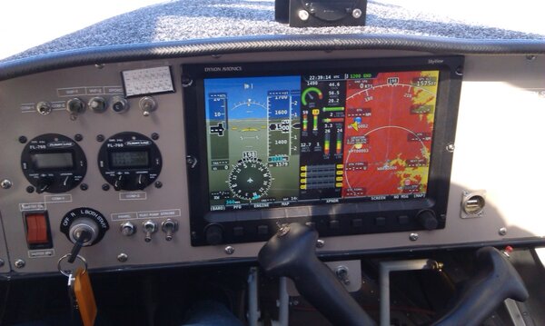

I have two Flightline 760s with which I am happy so far, around four years!
hu Derek - o argument but out of interest - why two radios?
Does this mean you have one channel active and are listening out on three?
As per Kyle Communications comment, it doesn’t scan between two channels, but I did it that way for a couple of reasons, 1) I got a good deal on the pair from Jabiru 2) When I was building I was close to Amberley airspace so it gave me redundancy (Ok, 3 reasons!!) 3) It does let me monitor two frequencies.

Flightline 760A looks like a choice for me, I will leave the mounted hand held in and then I have 2 radios, but need 2 antennas.
I guess it may be handy IF one radio goes down, I can use the second one.  The 760A is now about $1495 on Sky Shop, not sure IF that includes wiring harness?
