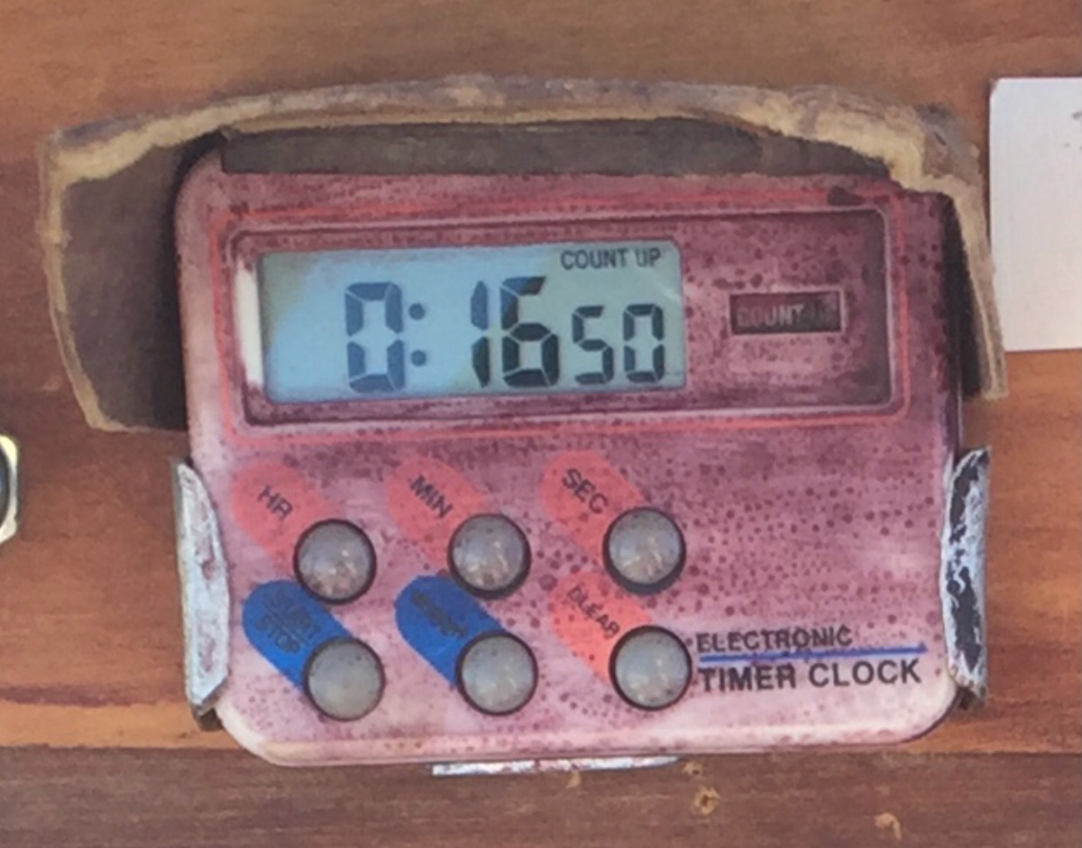

27 minutes ago, Old Koreelah said:
A cheap kitchen timer stuck to panel has served me well.
Problemo - most kitchen timers seem to only run for 60 minutes - not great if you have a 6 hr duration (not that I fly for more than 2-3 hrs at a stretch)
