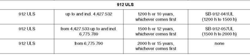

Well as you found on the rotax site no 912ULS has a TBO in excess of 12 years so you are past TBO based on years not hours so your engine is no longer available within TBO.
No idea if there are other than Bert Flood for overhaul in OZ but unless you can legit run your engine past TBO you have a big bill coming
The last info I had was there is no way to get over the time expiry. There is no specific procedure. This might as well be fully clarified if it can be, because it will have some relevance to many people. Nev
Does a bulk strip by a Rotax authorised overhaul facility (replacing ANY necessary parts) then bring the engine back inside calendar time with remaining engine hours to run to TBO?

Well as you found on the rotax site no 912ULS has a TBO in excess of 12 years so you are past TBO based on years not hours so your engine is no longer available within TBO.No idea if there are other than Bert Flood for overhaul in OZ but unless you can legit run your engine past TBO you have a big bill coming
The TBO for private use is a recommendation only. You can operate the engine beyond that if you so chose. Not for training or hire though.
well ...
the initial question was easy - yes, the engine is past TBO
is there anyone other than Bert Flood in OZ that can overhaul and reset the TBO - no idea but I do know how much it costs to TBO overhaul a 912 in the UK and its bascially financially better to replace than overhaul because ou can sell your past TBO engine to someone who doe not need the TBO for more than the difference in cost between overhaul and new engine.

Being this old, it will have the old crankcase style, have a 1200 or 1500 hour limit anyway......really not viable for rebuild......(but someone may take your money...)
If you really want it or need it to be "in spec" then as Kasper said, sell it "as is" at the best price you can get.......and get a new one.....

. On the expiration due time passing thing, I would want something from the maker in writing If there is a way to start the clock running again for the 10 or12 years etc IF they don't have a stipulated process I reckon there isn't one. Some items have a shelf life where they haven't even done any service.'
If you have certain situations like a prop strike etc you can strip and inspect. I know where a crankcase "O" ring was omitted in original assembly and it was just rectified by strip and fit.
Other information I have seen makes the cost prohibitive to recondition the motor. Often with quite a bit of time up they check out quite good, and you might do new seals gaskets valves and piston rings and end up with a good running motor.
Everything is quite expensive compared with Jabiru. The crank is pressed together so a bit of a specialised operation to inspect condition of bearings, compared with the usual bolted up conrod on a single piece crank. Nev

Thanks Paul for your information. On the expiration due time passing thing, I would want something from the maker in writing If there is a way to start the clock running again for the 10 or12 years etc IF they don't have a stipulated process I reckon there isn't one. Some items have a shelf life where they haven't even done any service.'
Nev, Rotax have always used pressed cranks even on their two strokes, as you probabily know, and the many hours of reliable service on both two and four strokes proves that they are a sound thing. The correct approval and equipment is available to disassemble and reassemble these cranks if necessary, it's not that big a deal. Additionally there are many Rotax engines out there globally right now, operating soundly and reliably well above stated TBO hours in private use. Indeed it is common knowledge amoungst users that most Rotax stated TBOs are very conservative.
Yes Ross, I understand that as I have been doing big ends on motorcycles since 1955, and manufacturing some of the parts used. Disassembling the 912 crank should not be undertaken lightly as the press fits have to be maintained and they don't run replaceable pins like two strokes do where you can make a slightly oversize pin.
The Rotax is best not fiddled with and that is one reason it stays reliable. I agree they can do high hours with very little wear. The "TIME (years) in service limit, rather than the hours run still needs to be clarified. Nev
