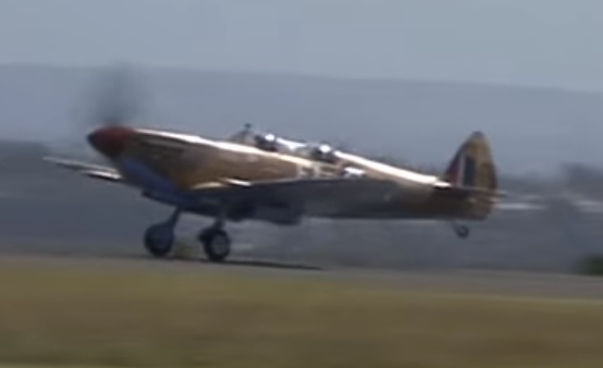

red750 Posted June 12, 2017 Share Posted June 12, 2017 Freeze frame of the moment the prop touched the ground. Compare the attitude to this image a second or two before liftoff. 1 Link to comment Share on other sites More sharing options...

Mick Posted June 12, 2017 Share Posted June 12, 2017 Freeze frame of the moment the prop touched the ground.[ATTACH=full]50759[/ATTACH] Compare the attitude to this image a second or two before liftoff. [ATTACH=full]50761[/ATTACH] Red750 you have shown nicely what I was describing in my post. Link to comment Share on other sites More sharing options...

kaz3g Posted June 12, 2017 Share Posted June 12, 2017 Watching a mass take off of 13 Spitfires at Duxford a few years ago, they don't let the tail get up to a normal flying attitude while on the ground. They hold the tail low until they fly off in that attitude. When we first see this Spit it is pretty much at a flying attitude & neutral elevator, maybe the tail should not be allowed to get that high to start with..... Exactly Mick..especially the later marques with the big props. They were designed to take off and land in the three point position and braking had to be done very carefully. The COG is only just behind the mains and they will overturn easily if a lot of care is not taken. When they were being run up, two or three airmen would sit on the tail to hold it down. Kaz 1 Link to comment Share on other sites More sharing options...
kasper Posted June 12, 2017 Share Posted June 12, 2017 Am I seeing things or did the main spar carry-through break as it flopped inverted?The rear view of it inverted in the first video appears to show way more dihedral than normal, and as the helpers release the wing it appears to be loose. If that's right, is it a real Spit or a replica? I can't imagine a real Spit breaking the wing in such a minor event. It's a real spitfire. It's a PRXIX and has been flying in France since 2006 in the original config. Prior to that it flew in the USA with a griffon and contra prop setup from a Shackleton Link to comment Share on other sites More sharing options...
Teckair Posted June 12, 2017 Share Posted June 12, 2017 Different angle Not exactly a Spitfire pilot myself but tailwheel experience all the same. IMHO tail was up too high too soon too slow. It looked for all the world like this was the first time this guy had flown that plane. You can treat some tail draggers that way but not that one. Link to comment Share on other sites More sharing options...
