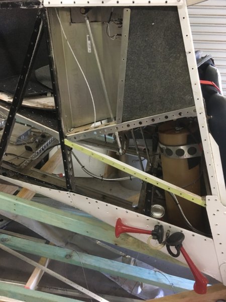

Both Dan3111 and my S...Mabel have airhorns fitted to them...both were used on propertys with animals...I presume mustering...I am putting the ones back onto Mabel..I think its a good idea. Steve Donald has a set on his Sav and he flew over my place at 1200 ft and I could hear his fine

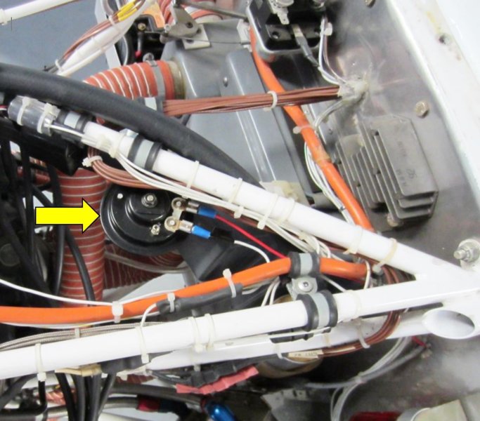

I installed a $15 automotive horn a couple of years ago (see it arrowed on photo attached) for the purpose of warning people on the ground if I found myself in a similar situation. Not long prior to doing this there had been an RV landing on a beach that hit someone and another aircraft trying to put down on a ski field that killed a woman - both incidents occurred in Europe. At the time there was a lot of bad press about the Jabiru engine, which I have a 3300A in my Arion Lightning. I also use it at the "clear prop" stage on engine start-up. It certainly gets people's attention, as is the intent. Whether it is effective in warning people on the ground of my presence 100~200m away I have no idea. It is mounted within the engine bay and is pointed toward the cooling air discharge opening in the bottom of the cowling.
  • Like 5
I hadn't thought of that; a good idea I will adopt.
You might need a bloody flashbomb..
