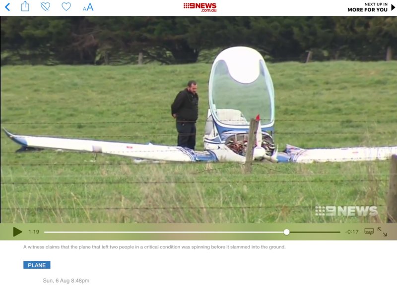

IMG_3247.PNG.fcdd030b211fefef3b8bcecab0b8201f.PNG Sadly Nicholas Cheung passed away on Friday afternoon. My thoughts are with his family and the school.
I hope his family made it in time to say their goodbyes.
At present the instructor is in a stable condition with facial, spinal and chest injuries.
Interesting maybe suggest flare too high loose ineritia sink flat pancake, learning in PA28 floating was the problem took ages to sink, good point the piece suggest LSA aircraft fly into the ground with low power rather than flare high with no power ??
Very sad. :( If you look at the pics (some show you a good span of the area) there are indicators that the plane had little forward momentum. Possibly in a flat spin. If it was spinning, not uncommon for the fan to stop during the spin.
In any case, very sad indeed. :( My thoughts are with the families.

These Daily Mail/Channel 10 photos show the fuselage shorn/deflected off the cockpit, the nose also shorn deflected off the cockpit, and the starboard wing twisted/distorted.
What we don't know at this stage is what the downforce was/what height it dropped from, but those breakaways/distortions may have saved the instructor's life.

At the end of the day the force landing didn't go well and a pancake arrival looks to occurred for which you cannot lay blame to the aircraft for that
If the aircraft was flown controlled all the way in to the force landing the result may have been far different
Yes the rear bulkhead looks to have parted and compromised the seat belts but that may very well have been from the type of arrival it under took for which the aircraft was not designed for
This is the most accurate..
"spinning" was prominent in one report but not even mentioned in the other. If I assume both are correct then perhaps spinning up higher and recovered from the spin, anyway, we will know more before long, just that I take a keen interest in spinning having known a few who were killed near that spot.
I just watched a news report that had video, and it appears there is very little forward momentum. No scrape marks on the ground at all. I hate seeing things like this. :( Just awful.
  • Agree 2
