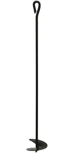

alf jessup Posted August 7, 2018 Share Posted August 7, 2018 I use this type of tiedown which came with the plane, recently on my trip to Ayers Rock I had no issue screwing them in to the hard red earth at Broken Hill & William Creek Was blowing consistently around 40kts at Broken Hill in the way up and they never loosened a bit. Need a little effort screwiing them right down but very secure, had the ropes splayed slightly forward & towards the wing tip side to the tie downs. Proved their worth to me 3 Link to comment Share on other sites More sharing options...

robinsm Posted August 7, 2018 Share Posted August 7, 2018 [ATTACH=full]61469[/ATTACH]I use this type of tiedown which came with the plane, recently on my trip to Ayers Rock I had no issue screwing them in to the hard red earth at Broken Hill & William CreekWas blowing consistently around 40kts at Broken Hill in the way up and they never loosened a bit. Need a little effort screwiing them right down but very secure, had the ropes splayed slightly forward & towards the wing tip side to the tie downs. Proved their worth to me Went through 2 sets of these in short order, Useless in hard ground, the screw part snaps off leaving you with a tent peg. I used the star picket idea and never had a problem in 6 years. Link to comment Share on other sites More sharing options...

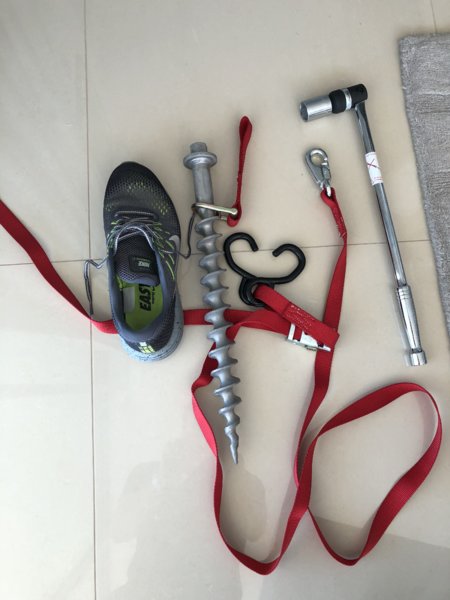

Bennyboy320 Posted August 7, 2018 Share Posted August 7, 2018 I recently ordered & received the “Big Srew tie down” the 18 inch screws & tie down straps & attachments look strong enough to use on a Dash 8, haven’t used it yet, will post update when back in Bne. Link to comment Share on other sites More sharing options...

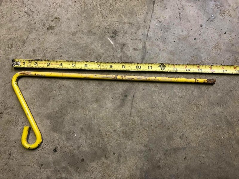

APenNameAndThatA Posted August 9, 2018 Share Posted August 9, 2018 There was a review of tie downs about 12 months ago in ? what magazine. The only two conclusions that I remember were that a) The Claw was not very good and b) the tie downs that the Boy Scouts make and supply to pilots visiting Oshkosk are great. No description of said Boy Scout tie-downs was given, however. Link to comment Share on other sites More sharing options...
Head in the clouds Posted August 9, 2018 Share Posted August 9, 2018 Scout peg - Link to comment Share on other sites More sharing options...
APenNameAndThatA Posted August 9, 2018 Share Posted August 9, 2018 Scout peg -[ATTACH]61502[/ATTACH] Thank you for that. Looks like there is compromise afterall. Those look heavy. What is the utility of the bent bit at the top, except as something to grab onto to twist and pull to get it out of the ground? It looks like it would just add weight. It would stop the rope being parallel to the axis of the peg, but you could achieve that by banging it in at a angle. Link to comment Share on other sites More sharing options...
OZJohn Posted August 9, 2018 Share Posted August 9, 2018 Obviously made from broken hay rake tines - spring steel. John. Link to comment Share on other sites More sharing options...
APenNameAndThatA Posted August 9, 2018 Share Posted August 9, 2018 Obviously made from broken hay rake tines - spring steel.John. Oh. Then those might have just been chopped off some disused farm machinery. Link to comment Share on other sites More sharing options...

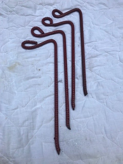

Carbon Canary Posted February 6, 2023 Share Posted February 6, 2023 Made myself a set of 'Boy Scout' tie-downs over the weekend using the image in this thread as a guide. I too had read the article in the "Australian Pilot" magazine from some years ago regarding the High Sierra fly-in incident. I used 10mm high tensile rebar which can be bent with a fair bit of swearing but without heat, if you try hard enough. I imagine if anyone had a proper rebar bender it would be a piece of cake. I haven't used these tie-downs in anger yet, but I like the simplicity and application of the physics involved. That said, I hope I never find out their limitation. Each peg weighs ~300g. Link to comment Share on other sites More sharing options...
skippydiesel Posted February 6, 2023 Share Posted February 6, 2023 Based on very little experience, a large dollop of common sense and observation of several types being used at" fly in's" All the "stake" types: Require a good sized hammer to get into hard ground - very heavy when you take into account the hammer. Not much cop on sandy/loose/wet soil types Provide great anchorage in dense/heavy soils The screw in's; Don't suit hard hard (baked/compacted) dense soils If have generous "flites" are good in looser/wet soils May require additional tools (hand/power) to put in/out - very heavy when you take this into account Provide great anchorage in light/loose/sandy soils Claw types: Yeah! ???? Best viewed as a marketing exercise. The potential customer should always remember the securing (resistance to movement/removal) qualities all fixing "devices" are to a large extent, limited by the characteristics of the material providing the anchorage. Home made; Tend to be overengineered/ heavy May not take into account the materials functional strength/characteristics Usually require something like a lump hammer to put in and a tyre leaver to remove Often overly large (volume/weight) All systems are best used at an angle to aircraft tie down point and the minimum of 3 should be placed so as to appose each other ie you don't want the lift forces acting vertically on the ground tie. Have yet to see a system that comes close to meeting all possible soil conditions. For my money the light weight, HT metal screw in's, with sizeable flights and a large lever "eye" that can accommodate a piece of wooden dowel as a handle, are the best compromise. Just because its sold through an aircraft accessory store or has an aeroplane on the front cover, is no reason to pay ridiculous extra dollars. 2 1 Link to comment Share on other sites More sharing options...
Carbon Canary Posted February 6, 2023 Share Posted February 6, 2023 Oh, and total cost for the home-made boy scout tiedowns was ~$6.........for the beer afterward. 1 Link to comment Share on other sites More sharing options...

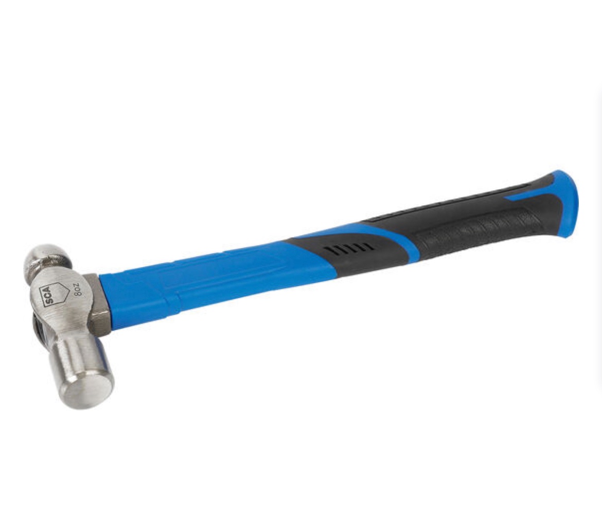

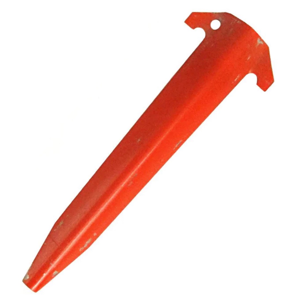

rodgerc Posted February 7, 2023 Share Posted February 7, 2023 I’ve just acquired 5 of these US army aluminium tent stakes, 12m of 8mm polyester rope and an 8oz SCA ball-pein hammer in a draw string bag. Total weight = 1.63 kg 1 Link to comment Share on other sites More sharing options...
Old Koreelah Posted February 7, 2023 Share Posted February 7, 2023 It occurs to me that if we have to carry the extra weight of a hammer, perhaps it should have more than one function; mounted in cockpit ready to smash through perspex? 1 Link to comment Share on other sites More sharing options...
