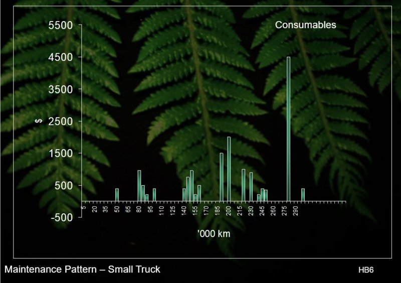

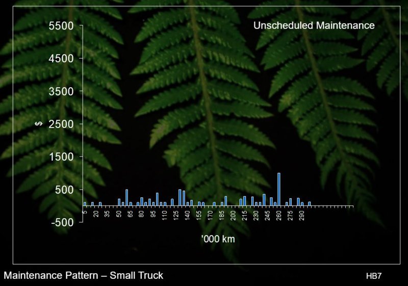

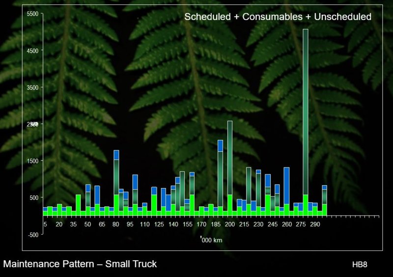

turboplanner Posted October 29, 2018 Share Posted October 29, 2018 Here are some generic graph patterns I was talking about earlier. The graph for scheduled maintenance is easy to forecast where the manufacture has specified it for you. Breakages, early failures and component failure are logged as Unscheduled maintenance, and this graph will quickly show up repeated failures due to design. Consumables are the items which need to be replaced at regular intervals; windscreen wipers, oil filters, hoses etc. The last screen shows the full repair and maintenance items. loaded together, which helps you put money aside for the peaks. An engine replacement will send that schedule sky high, but is critically important because they engine you choose may be the financial decider on how long you can keep flying. I'll stay away from aircraft engine discussions, but at one stage I was offering four cylinder trucks with an engine life over 500,000, and recommending they be sold at 400,000, giving subsequent owners like fruiterers two or three years cheap service. I was selling a lot of these trucks to the accountant of a large company and one day he told me had bought some other trucks because they were $5000.00 per truck cheaper than mine and that have saved the directors $30,000.00 The trucks he had bought had an engine life of 80,000 km on average, and engine replacement with labour was about $20,000.00 I told him I would go away and do some cost of life figures, coming back a few days to make these points. In year 1 the 5 trucks he had bought would save him the $25,000 plus about $5000.00 in maintenance If he bought another 5 of this make the next year, his savings would be about $40,000 for the year In Year 3, savings a little more Year 4 as the first of the engines failed, the savings reduced Year 4 into a loss Year 6 on, a loss of about $500,000 per year on the fleet Can't remember the exact curve, but it shocked the both of us and there were no more cheap trucks in that fleet. 1 Link to comment Share on other sites More sharing options...
