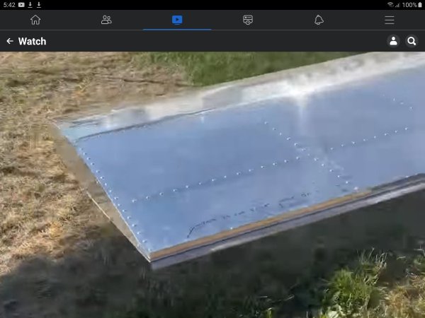

APenNameAndThatA Posted July 12, 2022 Share Posted July 12, 2022 ‘cording to Youtube, shiny aluminium is coated aluminium - aluminium alloy that is coated with pure aluminium. 10% weaker than aluminium alloy. I don’t understand why it’s made of shiny aluminium, unless they are going to make it do that people don’t have to paint it. Which would make it more likely to leak water. Link to comment Share on other sites More sharing options...

rgmwa Posted July 12, 2022 Share Posted July 12, 2022 (edited) 1 hour ago, APenNameAndThatA said: ‘cording to Youtube, shiny aluminium is coated aluminium - aluminium alloy that is coated with pure aluminium. 10% weaker than aluminium alloy. I don’t understand why it’s made of shiny aluminium, unless they are going to make it do that people don’t have to paint it. Which would make it more likely to leak water. Vans use 2024-T3 Alclad aluminium alloy for wing and fuselage skins. This has a pure aluminium coating on both sides which oxidises and provides corrosion protection. It needs to be scuffed and cleaned before priming and painting. Some builders like to polish it (hard work) but most paint their aircraft. As a prototype there isn’t much point painting this particular RV. Edited July 12, 2022 by rgmwa 1 1 Link to comment Share on other sites More sharing options...

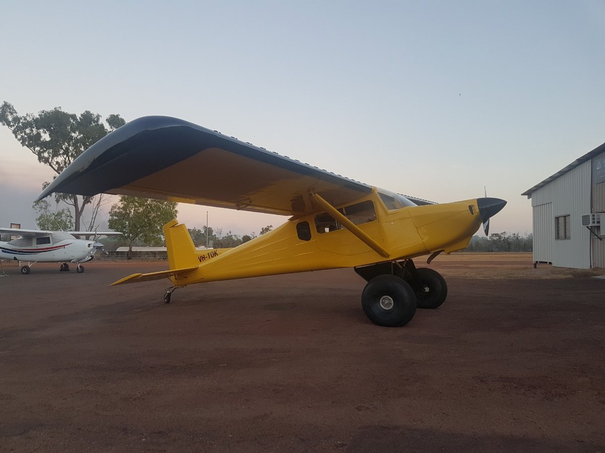

RFguy Posted July 12, 2022 Share Posted July 12, 2022 I reckon the Tailwheel Brumby 610 is a competitive aircraft. and made locally. Rotax 915 or Lycoming.... 3 1 Link to comment Share on other sites More sharing options...

jackc Posted July 13, 2022 Share Posted July 13, 2022 11 hours ago, RFguy said: I reckon the Tailwheel Brumby 610 is a competitive aircraft. and made locally. Rotax 915 or Lycoming.... I thought Brumby was part manufactured in China? Link to comment Share on other sites More sharing options...
