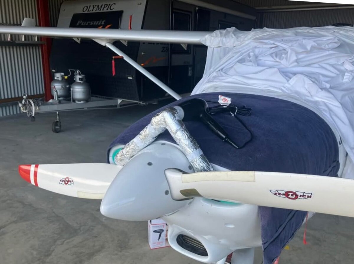

Earl Pike Posted Monday at 02:08 AM Posted Monday at 02:08 AM My Jabiru J230 is hangared in Porepunkah, NE Vic ( YPOK ); the winter temp is often below zero into mid morning.. I made an engine warmer from a bit of pvc plumbing and a hair dryer… works well.. 15 to 20 mins while doing checks and getting organised.. Starts like a summer day.. 4 1 2

danny_galaga Posted Wednesday at 01:31 AM Posted Wednesday at 01:31 AM On 16/06/2025 at 2:08 AM, Earl Pike said: My Jabiru J230 is hangared in Porepunkah, NE Vic ( YPOK ); the winter temp is often below zero into mid morning.. I made an engine warmer from a bit of pvc plumbing and a hair dryer… works well.. 15 to 20 mins while doing checks and getting organised.. Starts like a summer day.. Expand Fantastic! A friend did a similar thing to dry his motorcycle boots ☺️ If I ever live somewhere cooler, I'm stealing this idea! 2 1
