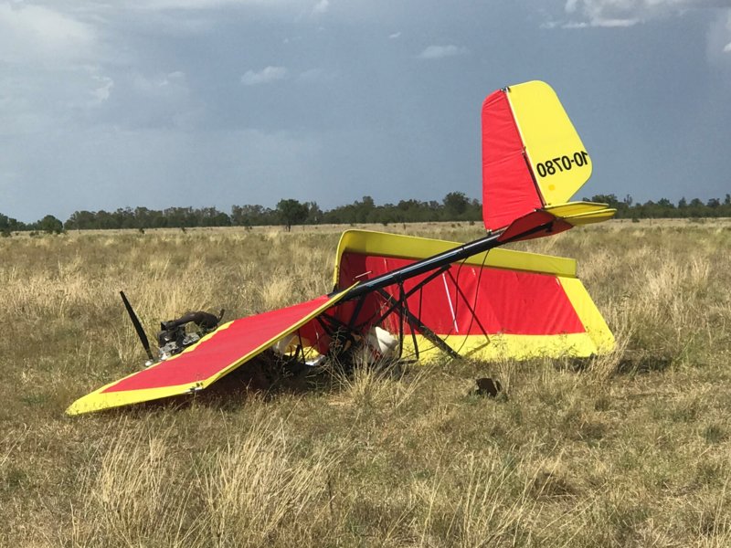

fly_tornado Posted January 14, 2018 Share Posted January 14, 2018 Just in The ultralight plane came down on the Gregory Highway, 15km south of EmeraldGoogle Maps by Amber Hooker UPDATE 9.30AM: A PILOT has died this morning after his aircraft crashed on the Gregory Hwy near Emerald. The Queensland Police Service have confirmed the man was the sole occupant at the time the ultralight plane came down 15km south of Emerald at about 7.35am. The Queensland Ambulance and Queensland Fire and Emergency services also attended the scene. Police advise the Forensic Crash Unit is investigating and federal aviation investigators have been advised. PLANE CRASH: Man killed as aircraft plummets into CQ highway 1 Link to comment Share on other sites More sharing options...

fly_tornado Posted January 14, 2018 Author Share Posted January 14, 2018 Pretty hard impact, news flipped the image 1 Link to comment Share on other sites More sharing options...
ave8rr Posted January 14, 2018 Share Posted January 14, 2018 Single seat Flightstar? RIP. Condolences to all. 1 Link to comment Share on other sites More sharing options...
pgpete Posted January 14, 2018 Share Posted January 14, 2018 Looking at the tail feathers and general configuration, I'm guessing that it was a Flightstar Pioneer. They were a nice aircraft back in the day.... My condolences to all involved. Link to comment Share on other sites More sharing options...

Teckair Posted January 14, 2018 Share Posted January 14, 2018 I always find it hard to see a crash like this in what looks like a clear area where a survivable out landing could have been made. 2 Link to comment Share on other sites More sharing options...
facthunter Posted January 14, 2018 Share Posted January 14, 2018 IS it actually a single seater? re the crash, something has to be very wrong somewhere to go IN like that .Nev Link to comment Share on other sites More sharing options...

onetrack Posted January 14, 2018 Share Posted January 14, 2018 I wonder, did the wing buckle in flight, or did it buckle on impact? The weather in the background looks a little stormy - but if he took off in the early morning as stated, then one would imagine the weather wouldn't have been a major causative factor in the crash. 10-0780 was built 29/07/1988, and the rego was cancelled 28/02/2006 and listed as WFU? Was it out of action for a length of time, then re-registered? Can't find a current registration date for it. The number of ultralight crashes and fatalities seems to be on the rise in recent times - or is it just one of those increased flying periods where the numbers spike? Why does QLD always seem to get a larger % of aerial disasters? Link to comment Share on other sites More sharing options...

turboplanner Posted January 14, 2018 Share Posted January 14, 2018 I always find it hard to see a crash like this in what looks like a clear area where a survivable out landing could have been made. The cause could be anywhere between what you say, and a breakup in normal flight from a pre-existing crack, or some exciting early morning attempted tight turns/aerobatics. I drove past that spot twice last year, and while the street-view photo looks good, a lot of those paddocks are very rough. Although it is reported that his instructor found the crash site, this was an early morning event, and it's not clear yet whether he had taken off with the permission of his instructor, or whether he had just decided to go off on his own. Link to comment Share on other sites More sharing options...
