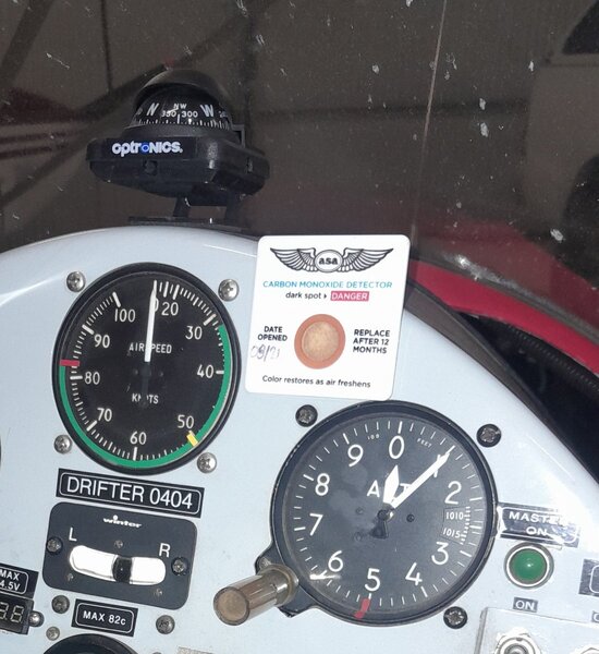

RFguy Posted October 3, 2020 Share Posted October 3, 2020 (edited) On CO detectors and planes..A little while back we were looking at backup AC generator fumes in a building, and the more expensive one read about half the cheapie. The cheapie was responsive to other combustion products in the air, and other gases, and the pricey one was not. However The cheapie always had a direct 2:1 correlation when it was exhaust gases... This is excellent reading : http://www.tc.faa.gov/its/worldpac/techrpt/ar0949.pdf A comprehensive FAA report Now, also it deals with the different types of CO detectors, the low end ones ($50) are accurate but they're also sensitive to other gases. be sure to read appendix D and B. The document is a consolidation of documents -glen Edited October 3, 2020 by RFguy 1 Link to comment Share on other sites More sharing options...
old man emu Posted October 3, 2020 Share Posted October 3, 2020 1 hour ago, RFguy said: the different types of CO detectors, the low end ones ($50) are accurate but they're also sensitive to other gases. Is that such a bad thing? Any chemical detector should be sensitive to the its designed chemical. If it is, great. But if it also detects other chemicals that we don't really want, then that's a plus. Imagine if your CO detector also happened to react to CO2. That is a dangerous gas in a confined space, and is a gas likely to be encountered in the cockpit. Also, we can only use up to 21% of the volume of air we breathe in. That's all the oxygen that is usually in it. If we go putting other gases in, even vapours like water and fuel vapours, we are reducing the amount of oxygen we can take in with every breath. I suppose that our body's protection system has developed so that if we can smell something, there's too much of it in the air. Try going near a teenage boy who has a can of Lynx. Link to comment Share on other sites More sharing options...
gareth lacey Posted October 4, 2020 Share Posted October 4, 2020 1 hour ago, old man emu said: Is that such a bad thing? Any chemical detector should be sensitive to the its designed chemical. If it is, great. But if it also detects other chemicals that we don't really want, then that's a plus. Imagine if your CO detector also happened to react to CO2. That is a dangerous gas in a confined space, and is a gas likely to be encountered in the cockpit. Also, we can only use up to 21% of the volume of air we breathe in. That's all the oxygen that is usually in it. If we go putting other gases in, even vapours like water and fuel vapours, we are reducing the amount of oxygen we can take in with every breath. I suppose that our body's protection system has developed so that if we can smell something, there's too much of it in the air. Try going near a teenage boy who has a can of Lynx. or using no lynx at all, is it me but i detect that most young people teens are rather smelly body odour ,yuk Link to comment Share on other sites More sharing options...
facthunter Posted October 4, 2020 Share Posted October 4, 2020 You olfactory senses have been evolved to warn you of the dangers of being near or consuming certain things, You can't smell CO or CO2 , CO2 is not poisonous, but will displace oxygen, so you can get oxygen deprivation. Nev Link to comment Share on other sites More sharing options...
RFguy Posted October 4, 2020 Share Posted October 4, 2020 (edited) Hi OME. you got it - that was the point I was making- the cheapies having some multi gas detection capability, will give you the warning you need.. 50ppm is the FAA limit, alarms from 35ppm recommended....and if (the cheapie) says 60ppm and you have actually 30ppm of CO (amongst all the other foul stuff from exhaust) that's enough trouble..... Reading that FAA document I posted, assuming the certified system was OK, old mufflers and old exhaust systems/manifolds (> 1000 h) are the biggest trouble. and seals in airplanes go bad after a while, also. like I said, eye opening reading. -glen Edited October 4, 2020 by RFguy Link to comment Share on other sites More sharing options...
