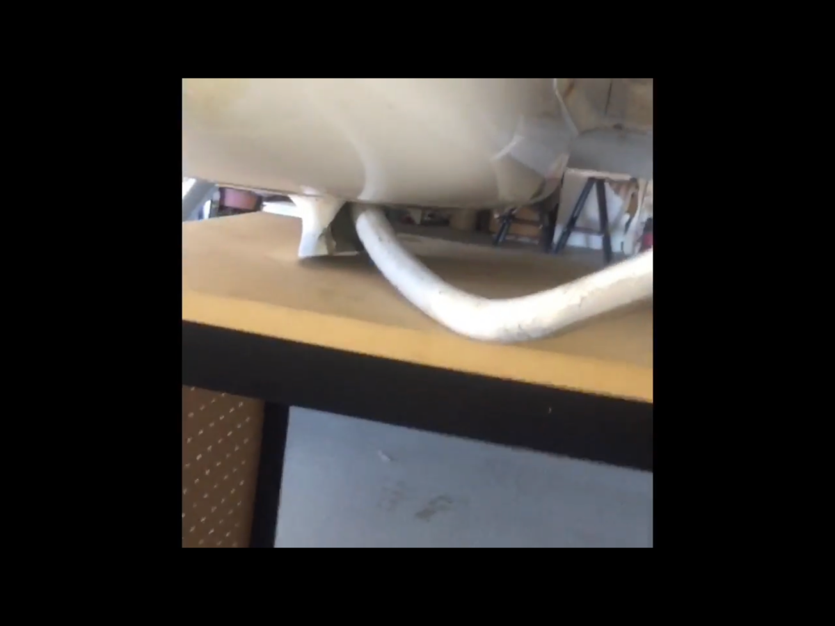

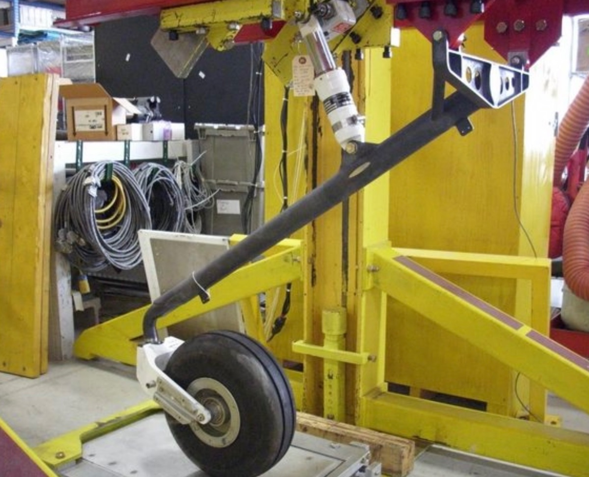

Mike Gearon Posted January 23, 2023 Share Posted January 23, 2023 Here are some nose wheel examples. Below from a YouTube similar accident to the one the other day and similar result in RV tricycle gear. The point of failure obviously the solid spring steel shaft of I’d say 1” dia. Given a preference I’d rather be stronger here and bending the engine mount and firewall and landing without ploughing the ground. 2nd image is the RV10A engine mount. Obviously a revision for a reason. 3rd is Cirrus SR22. I don’t really understand the forces involved that you’d think would bend the shaft upward toward the propellor when in fact they bend it toward the ground and then around in a U shape. The pivot may provide the nosewheel shaft more chance to deflect upward and absorb load and at the end of travel the spring steel can possibly flex in the correct direction to continue absorbing load. I know an aircraft designer pretty well and I’m going to ask! Link to comment Share on other sites More sharing options...
turboplanner Posted January 23, 2023 Share Posted January 23, 2023 4 minutes ago, Mike Gearon said: Here are some nose wheel examples. Below from a YouTube similar accident to the one the other day and similar result in RV tricycle gear. The point of failure obviously the solid spring steel shaft of I’d say 1” dia. Given a preference I’d rather be stronger here and bending the engine mount and firewall and landing without ploughing the ground. 2nd image is the RV10A engine mount. Obviously a revision for a reason. 3rd is Cirrus SR22. I don’t really understand the forces involved that you’d think would bend the shaft upward toward the propellor when in fact they bend it toward the ground and then around in a U shape. The pivot may provide the nosewheel shaft more chance to deflect upward and absorb load and at the end of travel the spring steel can possibly flex in the correct direction to continue absorbing load. I know an aircraft designer pretty well and I’m going to ask! If you round out to a tail-down attitude (rotate this photo to the right), the aircraft lands on the mains, taking any initial bumps or holes without the nose wheel touching. If you pull the stick back fully as it is rolling on the mains, the aircraft has rolled quite a distance, and slowed down quite a bit before the nose wheel touches, and when it does it will be at this angle. At this angle, castor looks good and the strut is laying back enough to bend with extreme bumps with the nose wheel coming up forwards. If you ever, in an effort to force the aircraft on to the ground, lower the nose near the ground, tilt the photo around to the left. When the nose wheel strikes at flying speed it wants to bend the strut backwards, shortening the wheelbase, and that let's the nose slam into the dirt. The forces in this scenario are many times the forces the undercarriage was designed for. You then have this much greater force not simply flexing the strut, but pointing it at the ground. Take a fishing rod, sit one end on a horizontal surface and make it flex very predictably, then put the end against a vertical surface, and push; the result is more violent and less predictable. Link to comment Share on other sites More sharing options...

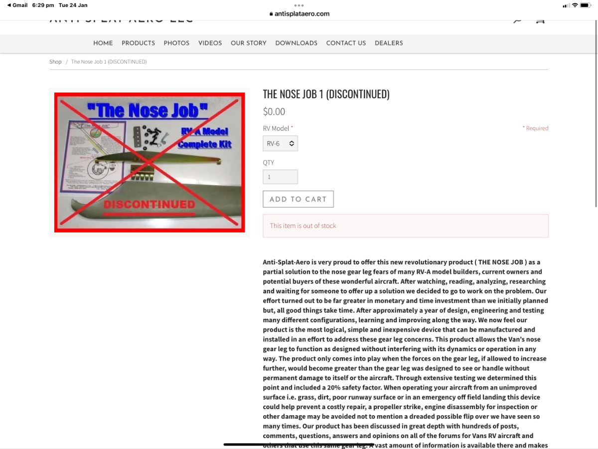

RossK Posted January 23, 2023 Share Posted January 23, 2023 This company specialises in RV extras, started with a reinforcement for the nose leg, called Anti Splat Aero ! 😬 Antisplat 1 1 2 Link to comment Share on other sites More sharing options...
kgwilson Posted January 23, 2023 Share Posted January 23, 2023 RV & SR22 chromolly nose legs are quite long and the Nose Job is well engineered and would appear to be effective, especially as if you do bend the nose leg it in theory pushes the nose up rather than in to the ground without it. Mine is far too short for such a system and it doesn't flex much. Still I land on the grass and on some rough strips. There is no secret, just keep the weight of the nose by increasing up elevator progressively from touchdown till walking pace. It took a while to master initially due to the sensitiveness of a full flying elevator (stabilator). What you don't want to happen is for the aircraft to leave the ground again as it can quite easily drop the nose heavily after it stalls again. 1 1 1 Link to comment Share on other sites More sharing options...
Mike Gearon Posted January 24, 2023 Share Posted January 24, 2023 They discontinued the anti splat! Link to comment Share on other sites More sharing options...
rgmwa Posted January 24, 2023 Share Posted January 24, 2023 (edited) No, there's a Mark 2 Version. Edited January 24, 2023 by rgmwa 2 1 Link to comment Share on other sites More sharing options...

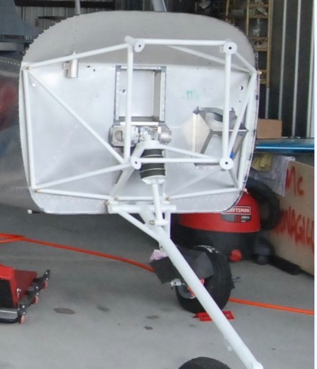

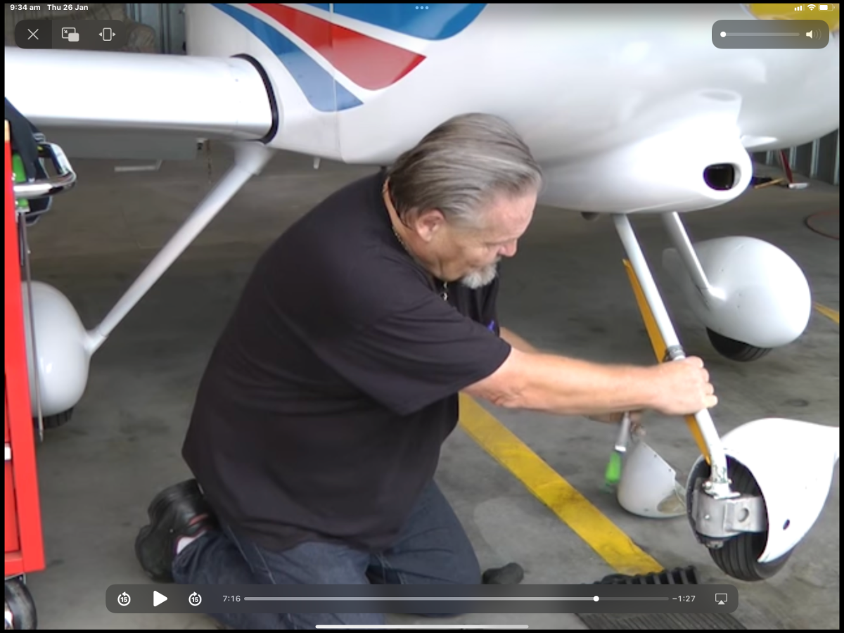

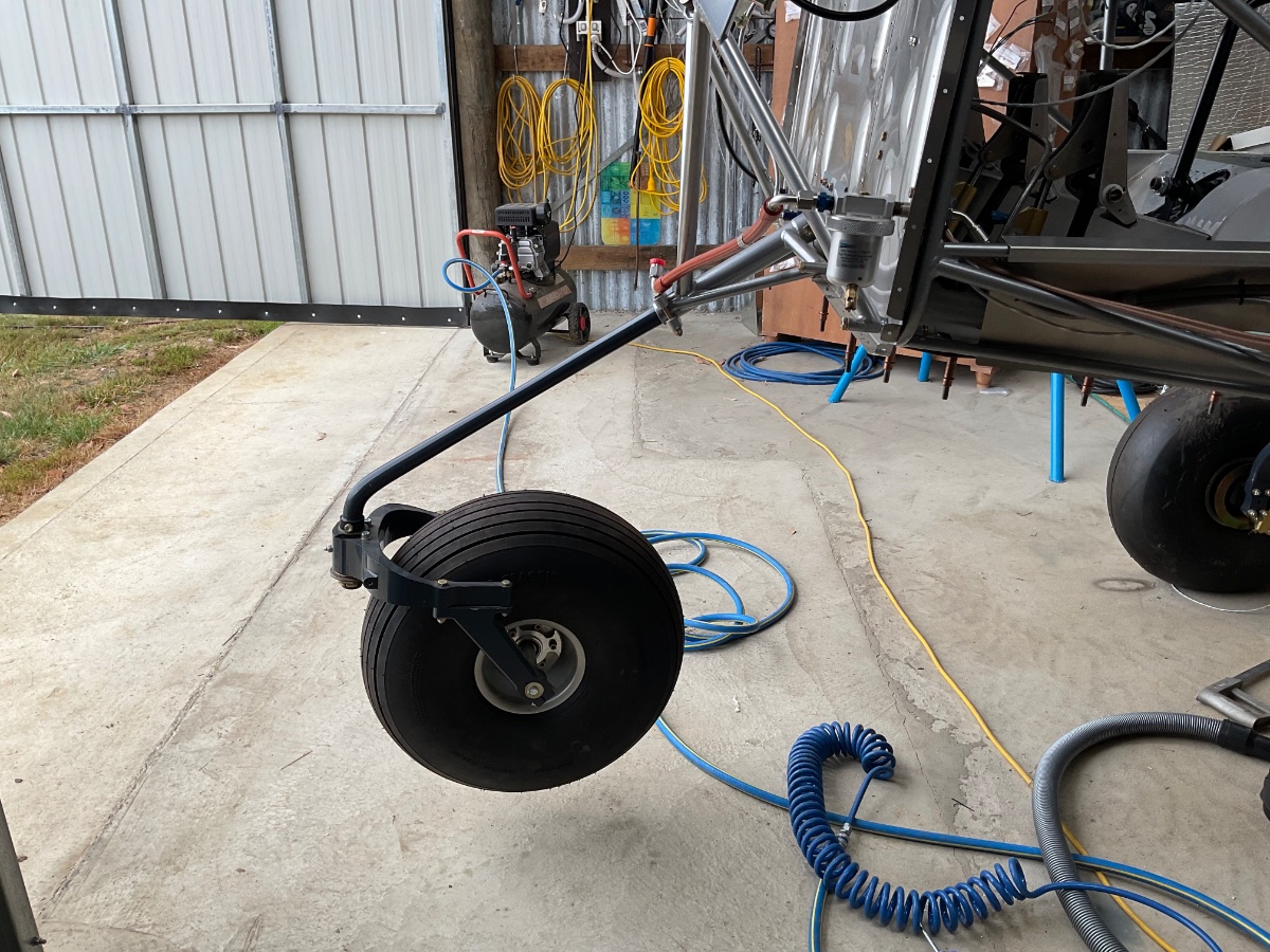

Mike Gearon Posted January 25, 2023 Share Posted January 25, 2023 (edited) 1. After watching the video definitely need an escape hammer in low wings. That hammer had a sharp end I think. 2. The new anti splat. Thanks for pointing it out! I’ve also included a pic of our Rans S21 nose gear. I’m fairly certain it’s the same USA supplier makes both Vans and Rans shaft when you look at the area that connects inside engine mount tube. The Rans has a number of reassuring differences that make it look much more likely to deflect in the correct direction under extreme load. Might still buy an anti splat for it. It’s a clever design. Obviously allows the shaft to flex in normal use and is only loaded if things are going in the splat direction. It’d be interesting to see an example where it was tested in the extreme. Edited January 25, 2023 by Mike Gearon Link to comment Share on other sites More sharing options...
facthunter Posted January 25, 2023 Share Posted January 25, 2023 Not a fan of castering nosewheels. Do they ever have shimmying problems? Nev Link to comment Share on other sites More sharing options...
turboplanner Posted January 25, 2023 Share Posted January 25, 2023 51 minutes ago, Mike Gearon said: 1. After watching the video definitely need an escape hammer in low wings. That hammer had a sharp end I think. This one has a harness cutter as well: 1 1 Link to comment Share on other sites More sharing options...

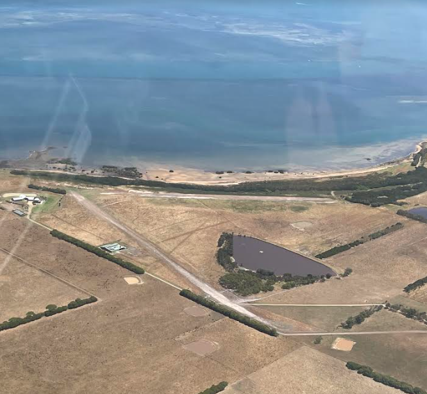

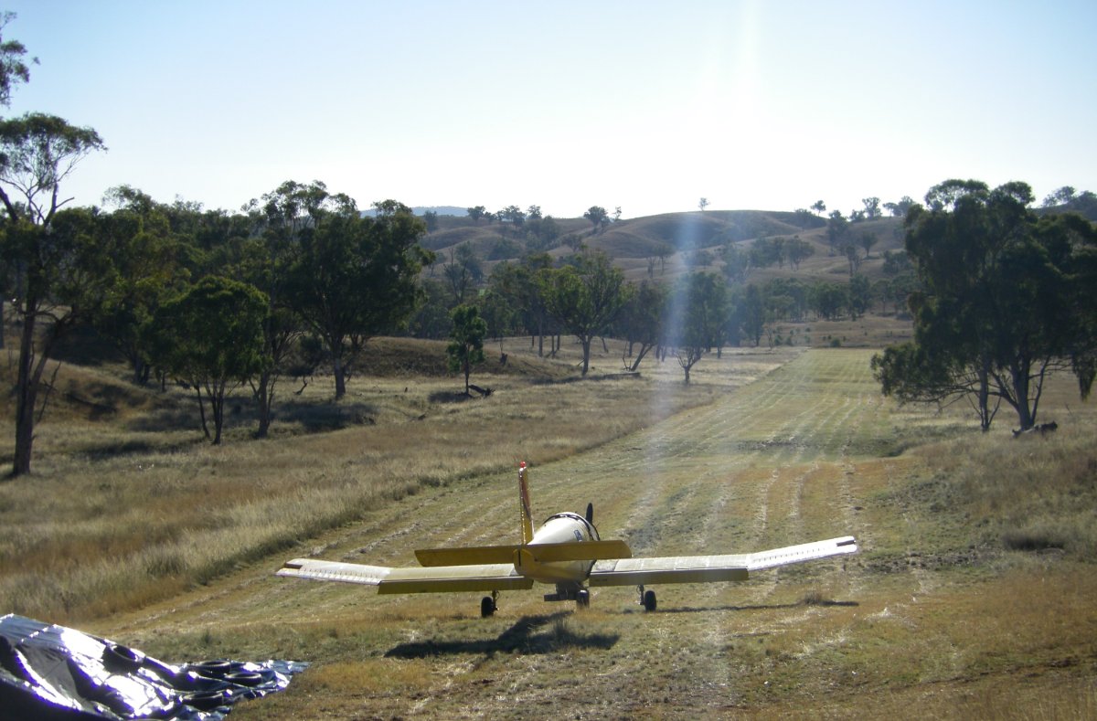

SGM Posted January 27, 2023 Share Posted January 27, 2023 I flew over French Island yesterday with my daughter... is this the strip? @Mike Gearon is this yours? Link to comment Share on other sites More sharing options...
Mike Gearon Posted January 27, 2023 Share Posted January 27, 2023 That’s my strip. Not the one. Just putting in the east west you see. Waiting on the grader to fix both runways. Landed a few weeks back on north south with a 20kn east cross and it wasn’t pretty. The ups and downs kept putting the pipistel back in the air. 2 1 Link to comment Share on other sites More sharing options...
