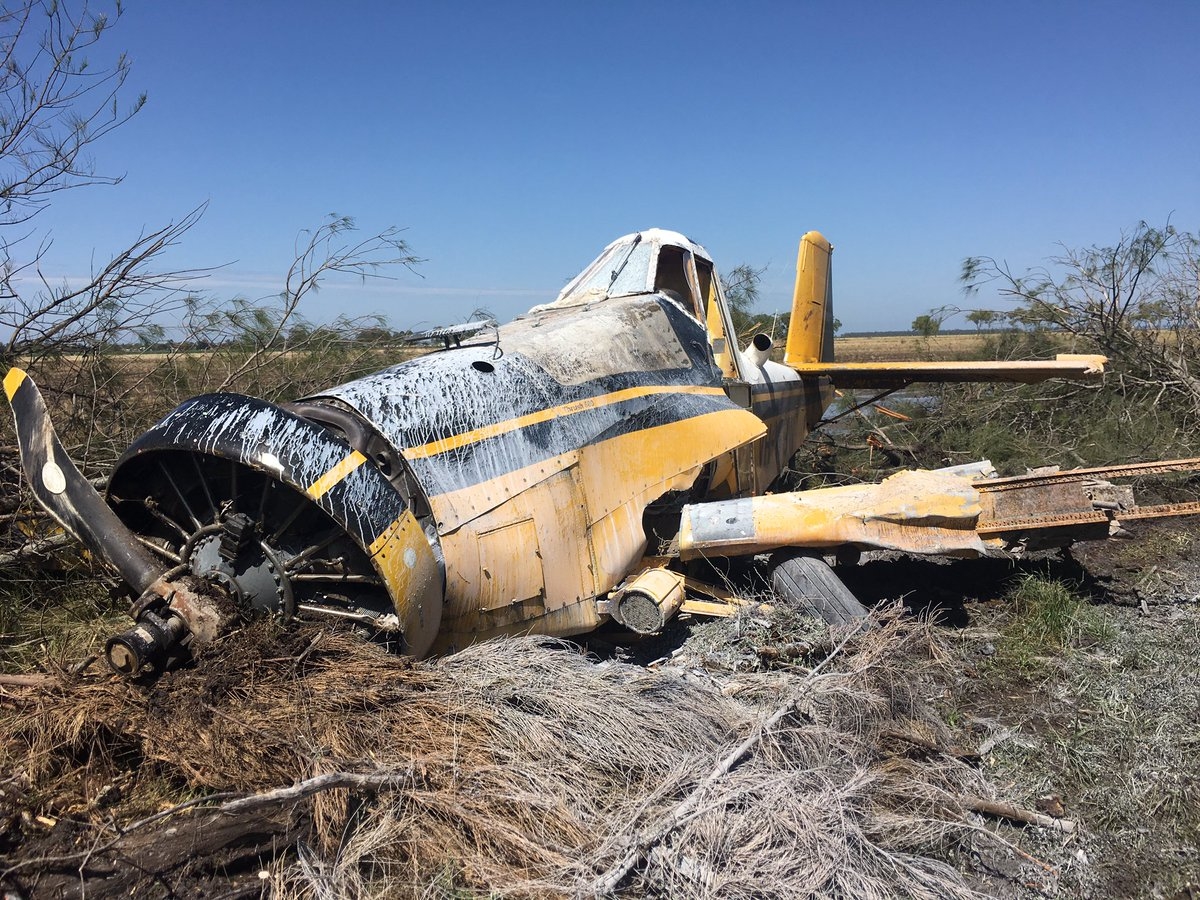

facthunter Posted December 21, 2018 Share Posted December 21, 2018 Built like a brick $#1thouse. With a radial and drum refueling anything can happen. Some (perhaps most) of them run mogas. Takes a bit of a thump to do that amount of damage. Nev. Link to comment Share on other sites More sharing options...
M61A1 Posted December 21, 2018 Share Posted December 21, 2018 Very lucky not to end up on his back, really wet at the moment and black soil out there. Dalby copped a bit of the storm the other night, just south of them got 270mm a a few hours. Link to comment Share on other sites More sharing options...

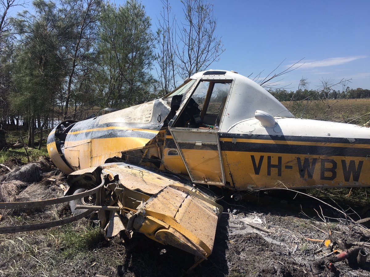

BLA82 Posted December 21, 2018 Share Posted December 21, 2018 A quick rego search shows that aircraft has been binned twice before. Maybe after the now third it might be time for scrap Link to comment Share on other sites More sharing options...
poteroo Posted December 21, 2018 Share Posted December 21, 2018 Possible it might not have dumped the fertiliser completely before touchdown - hence the apparent heavy impact. Fertiliser 'bridging' in the hopper used to be a major issue, (prevented rapid dumping), back in the superphosphate days, (lots of fines in it), but urea less likely to do this. Perhaps in very humid conditions it might? No aggie wants to be facing a forced landing at MTOW! And if the paddocks were wet, maybe the weight, and high vertical ROD, actually prevented the gear digging in and causing it to go A over T? A good result in anyones' language. happy days, 1 Link to comment Share on other sites More sharing options...
IBob Posted December 21, 2018 Share Posted December 21, 2018 Even without bridging, superphosphate just won't dump very fast. I walked over the site where a Beaver went down, having missed his line on takeoff from a long ridge, and gone off the side with insufficient airspeed. He was dumping as he left the ridge, 'flew' down the valley and pancaked into the valley floor a few hundred meters on. The amount of super he'd managed to unload was negligible. Link to comment Share on other sites More sharing options...

facthunter Posted December 21, 2018 Share Posted December 21, 2018 These guys are pretty much ready for an engine failure at any time and usually fly at low height all the time. Those motor's get worked. The plane is just a tool to get a job done. I'd prefer a turbo prop myself as I've seen some croppy radials stripped. and not too impressed with how they look in there. You love em and you hate em. . I'll get over it one day. maybe.. Nev Link to comment Share on other sites More sharing options...
fly_tornado Posted December 21, 2018 Author Share Posted December 21, 2018 that soil is extremely water logged after the recent rain. Link to comment Share on other sites More sharing options...
