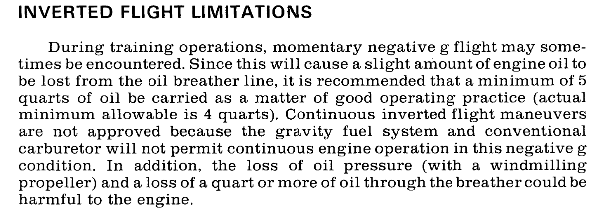

djpacro Posted January 22, 2022 Posted January 22, 2022 Cessna 152 Aerobat simply has this note in the POH. The 7ECA Citabria with the same powerplant doesn't bother. 1
facthunter Posted January 22, 2022 Posted January 22, 2022 That's pretty reasonable and practical advice but if you were in a situation where the choice is not available the way I covered it will be OK. . The plane will fly inverted but the engine won't be particularly well adapted. I'd rather the engine vented a bit of oil than got buried in the ground if that's your option. Nev 1
