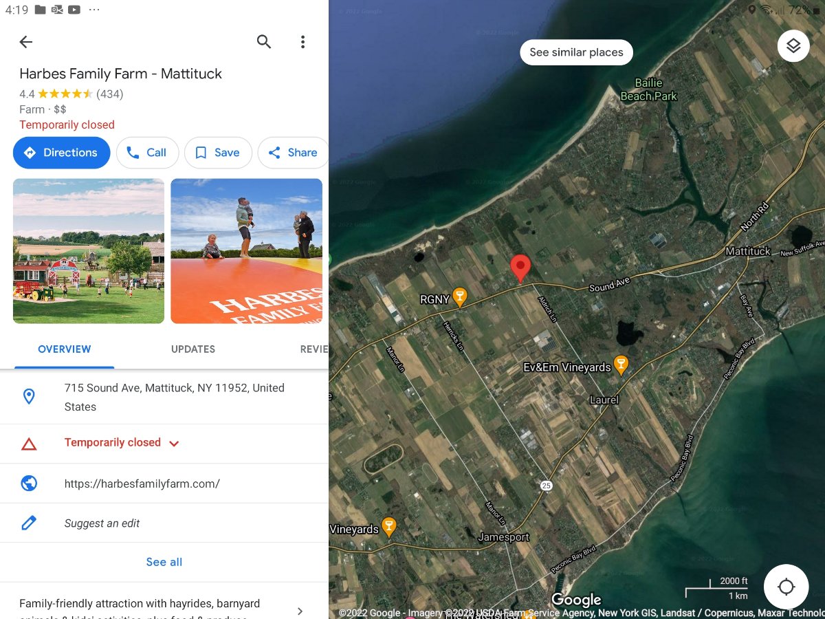

Thruster88 Posted January 21, 2022 Posted January 21, 2022 The engine, which had given plenty of WARNING that it was not in good health failed at 3000 feet over flat farm land with a wind from the north east at 10knots. The late decision to turn down wind while not maintaining adequate airspeed sealed their fate. Even without the wing drop (stall) they would have had a 20 knot higher touch down speed than a landing to the north east. The aircraft crashed in this area. http://www.kathrynsreport.com/2019/06/beechcraft-a36-bonanza-n8014t-fatal.html
