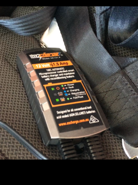

Bennyboy320 Posted May 2, 2018 Share Posted May 2, 2018 Been using the oz charge kit for about 18 months now, very happy with the device, it’s sometimes 4 or 5 months between flights for me, no battery problems so far, touch wood. Link to comment Share on other sites More sharing options...
