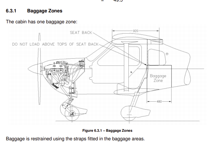

“You wouldn’t do”....i have, would do again. The jabs are way under specked. I have no problems openly admitting that. My confirmation person said “ if it gets off the ground it will fly no problems ) and it did. Takeoff took longer, climb was slower, nothing else changed. Boo Hoo as hard as you like, doesn’t bother me. The fact remains, jabs are under specked. “Rules” ......we are all guilty of breaking those in life’s journey
Where does that put the centre of gravity? That is even more important than the overall weight.
Your "confirmation person" doesn't sound like someone who gives good advice.
  • Agree 2
Overloading structurally is a trap as the margins on SOME designs is not there in the original design to take risks. With a Murphy rebel or some jabiru's that is not the case if you are under the top weight allowed and your "variant" isn't lightened in some way. I prefer my planes to be over strong with some of the situations we encounter these days with turbulence etc. Over loading is life of structure reducing and the load able to be safely carried as planes age, reduces. Aerobatic planes have more required inspections  and a "G" meter fitted and lower life of spars etc. SOME U/L's would have a quite low airframe life whereas  some well built stuff will do 70,000 hours and still come up OK after inspection and Non destructive testing. Nev
