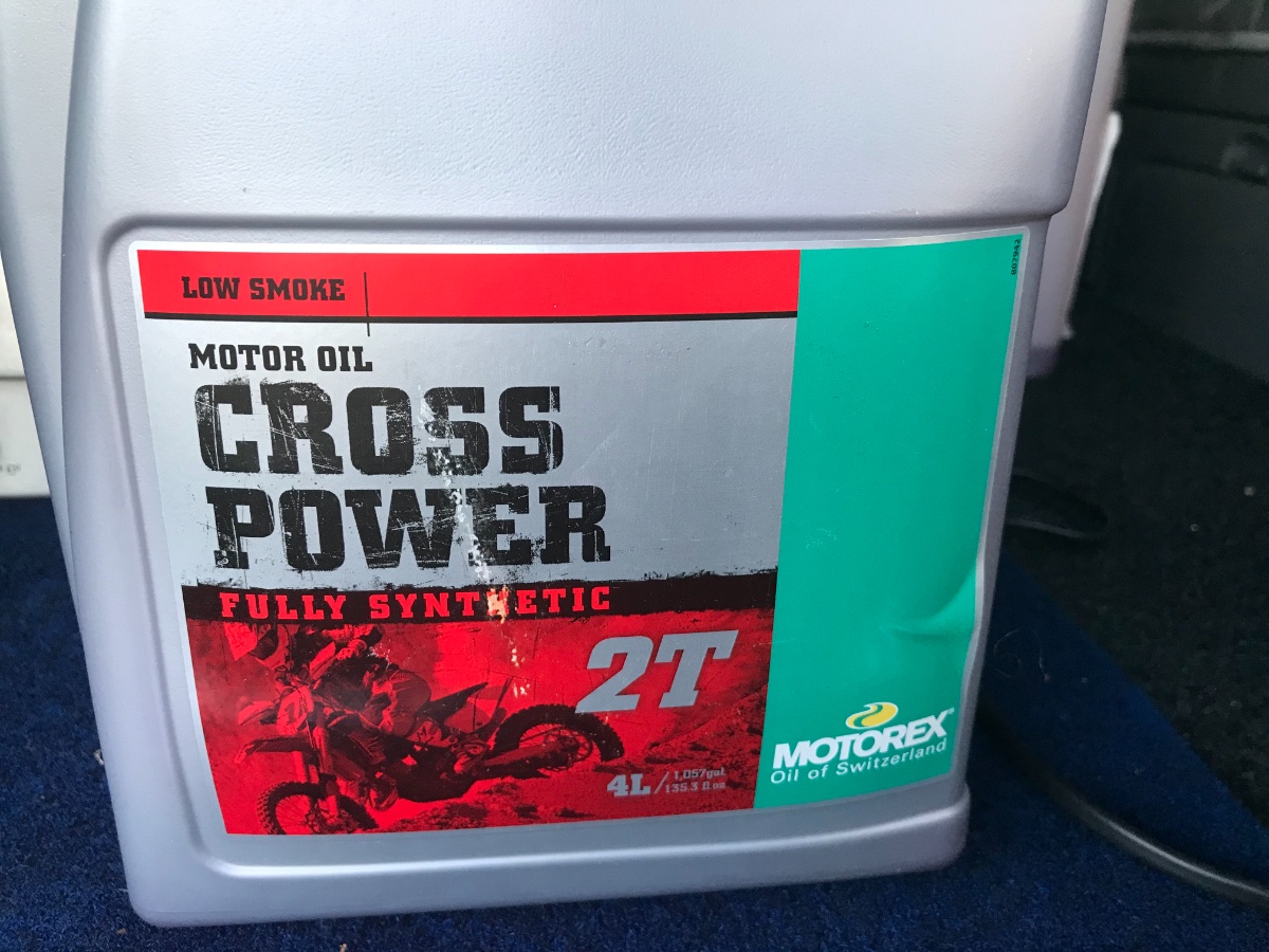

This is the suggested oil the  previous owner of my 582 powered Thruster was using……
Edited by jackc
spelling
I am sure Rotax recommend a mineral oil. I have always used Castrol tt later called 2t. Never had a ring stick in the last 37 years. synthetic is not recommended because it is hydroscopic?, it absorbs water and can cause corrosion, something ball and needle roller bearings can not tolerate. The 582 is not highly strung and synthetic is not required.
