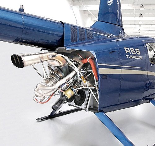

Thruster88 Posted April 8, 2022 Share Posted April 8, 2022 This is an article about the development of the Allison 250 engine in the late 50's. This engine started out with 250hp. New price now about 300k usd. It would be seem to be an ideal candidate for a recuperator since the compressed air passes by the exhaust area in external tubes. Why haven't the engineers done this if it gives 10-20 improvement in fuel efficiency? https://verticalmag.com/features/thelittleenginethatdid/ Link to comment Share on other sites More sharing options...
Geoff_H Posted April 9, 2022 Share Posted April 9, 2022 On 07/04/2022 at 5:50 PM, kgwilson said: Fuel consumption compared with performance has always been the bugbear of all small turbines & I don't think that issue has really been addressed. I worked in Florida on the design of 185MW gas turbine. The efficiency of a gas turbine depends heavily on the maximum turbine first row of blade temperature. To get high temperatures you need very exotic blade materials, as a rule of thumb the more you pay the better the efficiency. These people are getting better efficiency by using heat from the exhaust to increase the volume of compressed air so not so much fuel is used to get to maximum temperature. It is used by a company called micro turbines, small medium efficiency turbine manufacturer. I hope the guys are a great success. 2 1 Link to comment Share on other sites More sharing options...
Geoff_H Posted April 9, 2022 Share Posted April 9, 2022 4 hours ago, Thruster88 said: This is an article about the development of the Allison 250 engine in the late 50's. This engine started out with 250hp. New price now about 300k usd. It would be seem to be an ideal candidate for a recuperator since the compressed air passes by the exhaust area in external tubes. Why haven't the engineers done this if it gives 10-20 improvement in fuel efficiency? https://verticalmag.com/features/thelittleenginethatdid/ Recupetators weigh! Stationary engines of larger size don't use them because of pressure losses in exhaust gas, pressure loses affect turbine output. 2 Link to comment Share on other sites More sharing options...
