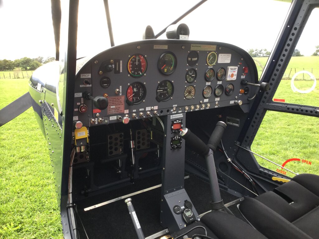

Thruster88 Posted December 29, 2019 Share Posted December 29, 2019 This is my 63' musketeer which I only fly for recreational purposes, before and after. Panel restored to factory colour, old junk removed. The new Trigg is awesome. It is old school and I feel very comfortable with it. 2 Link to post Share on other sites

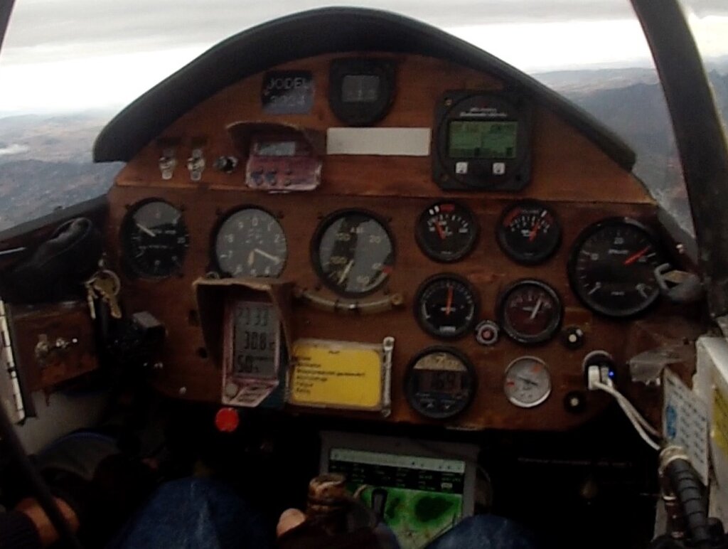

Old Koreelah Posted December 29, 2019 Share Posted December 29, 2019 I too cannot afford a glass panel, but their lightweight and simplicity intrigue me. My plywood panel is meant to match the handles for throttle, trim and stick, made from Rosewood I inherited from my father, who cut the timber from a tree that fell in the 1930s. As well as long-lasting, it's heavy timber, but I like to be holding a nice momento of my dad while flying. Flying instruments on the left, with engine gauges in the right. It's meant to flow from the bottom: fuel flow and fuel pressure, then electrical flow and electrical pressure, oil temperature and oil pressure, with burn readings on top. 6 Link to post Share on other sites

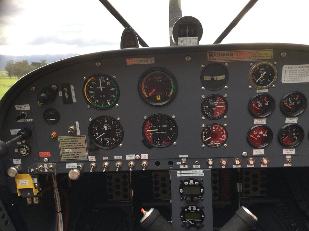

Blueadventures Posted December 29, 2019 Share Posted December 29, 2019 Hi Danny This is what I did. Some considerations in my opinion are: Tacho only needs to be small size; My engine instruments had provision for lamps (green arc off, yellow caution arc blinking and red arc lit. very good for reference or getting attention.) I wired for started engaged lamp (Solenoid fault etc saves destroying starter and battery if solenoid keeps starter engaged.) Also have lamp for low fuel as I fitted a Savannah collector tank 6 litre size and lamp on at 5 litres remaining in collector tank. Re switches I fitted a number of combined switch / circuit breaker to save space on panel. Re fastenings I fitted two camloks each side so to open panel for access is just two 90 degree turns (very convenient). Wiring is marked with circuit description (fine pencil text held in place with clear heat srink so wiring is identifiable and wiring diagram is easily followed.) My turn and bank is planned for a swap out when funds are available. Also position radio and transponder where your can see it (High on panel better). Cheers. 4 Link to post Share on other sites
skippydiesel Posted December 29, 2019 Share Posted December 29, 2019 Looks like you put a lot of thought into it. Looks neat, AND useful! I see you have the slip indicator off to one side. I wasn't sure if it had to be central or not so I've designed my panel with it central. The "slip" indicator you are referring to is actually an inclinometer. Added as an afterthought, it is just a surface mount (double sided tape). Far to sensitive for regular use. My slip ball is actually in the little central electronic gizmo AvMap Ultra. There are instrument layout conventions but they are not law - you can pretty well mount the gauges where it suit you - as long as you have the basics for safe flight/navigation. Hi Danny This is what I did. Some considerations in my opinion are: Tacho only needs to be small size; My engine instruments had provision for lamps (green arc off, yellow caution arc blinking and red arc lit. very good for reference or getting attention.) I wired for started engaged lamp (Solenoid fault etc saves destroying starter and battery if solenoid keeps starter engaged.) Also have lamp for low fuel as I fitted a Savannah collector tank 6 litre size and lamp on at 5 litres remaining in collector tank. Re switches I fitted a number of combined switch / circuit breaker to save space on panel. Re fastenings I fitted two camloks each side so to open panel for access is just two 90 degree turns (very convenient). Wiring is marked with circuit description (fine pencil text held in place with clear heat srink so wiring is identifiable and wiring diagram is easily followed.) My turn and bank is planned for a swap out when funds are available. Also position radio and transponder where your can see it (High on panel better). Cheers. [ATTACH]42750[/ATTACH] [ATTACH]42751[/ATTACH] [ATTACH]42752[/ATTACH] [ATTACH]42753[/ATTACH] [ATTACH]42754[/ATTACH] [ATTACH]42755[/ATTACH] [ATTACH]42756[/ATTACH] Hi Danny - Nice panel. Very professional. Are you able to easily reach radio/transponder in flight ? Like you all my wiring & pitot/static tubing is al labelled. The two 1/2 panels in my aircraft are held in place with 4 x 10 mm lock nuts onto anti vibration blocks. The Ram mounts for my Garmin & Ipad allow placing the item/screen at the best viewing angle and changing the angle in flight to negate sun glare. Do you have a CO2 monitor ? The extra gauge AH - who sells it ? how much? Why have you chosen this one? Link to post Share on other sites

Blueadventures Posted December 29, 2019 Share Posted December 29, 2019 New still getting approval. 1.5k US. Info on google AV-30. Similar is on my wish list; but I don't want to go glass. CO2 out of image above to port. Radio and transponder in easy reach. Should have added for Danny that I chose seperate ignition and start switches rather than a combined asc type keyed switch. Cheers Link to post Share on other sites
skippydiesel Posted December 29, 2019 Share Posted December 29, 2019 New still getting approval. 1.5k US. Info on google AV-30. Similar is on my wish list; but I don't want to go glass. CO2 out of image above to port. Radio and transponder in easy reach. Should have added for Danny that I chose seperate ignition and start switches rather than a combined asc type keyed switch. Cheers Yeah! My power on, master, ignition L/R & start are all separate switches. If I needed to (in flight fire) could isolate all non essential electricals while leaving engine to run. Link to post Share on other sites

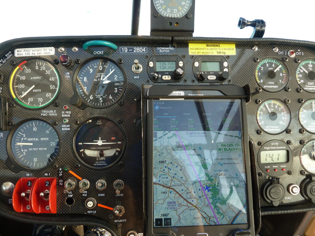

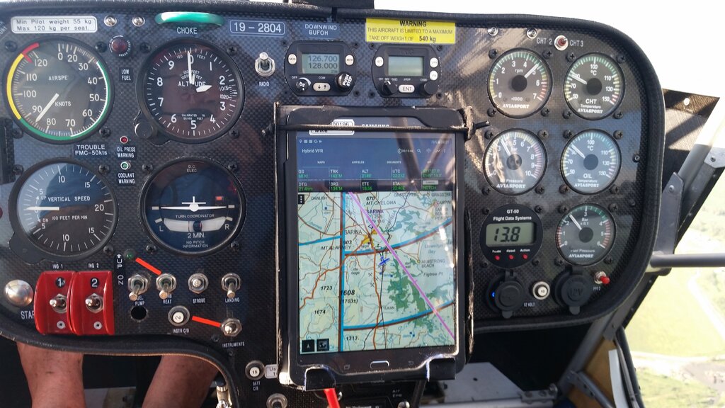

perrynz Posted December 29, 2019 Share Posted December 29, 2019 Here’s my Savannah S panel. The instruments I tend to focus on are the VSI (I find it great for fine tuning my hands off trim flight), and the AoA (Angle of Attack/lift reserve) The AoA gauge sits in my peripheral vision and is absolutely amazing. It takes into account the total aircraft weight in determining how close to the stall speed I am at. (There can be considerable difference in the stalling speed between that of a lightly loaded aircraft, and one that is flying at its MTOW) For a STOL type aircraft, it provides peace of mind when flying very slowly and also talks to me through my headset when close to the stall, all without needing to look at the ASI, therefore allowing me to keep my eyes focussed outside the cockpit on landing and takeoff. 5 Link to post Share on other sites

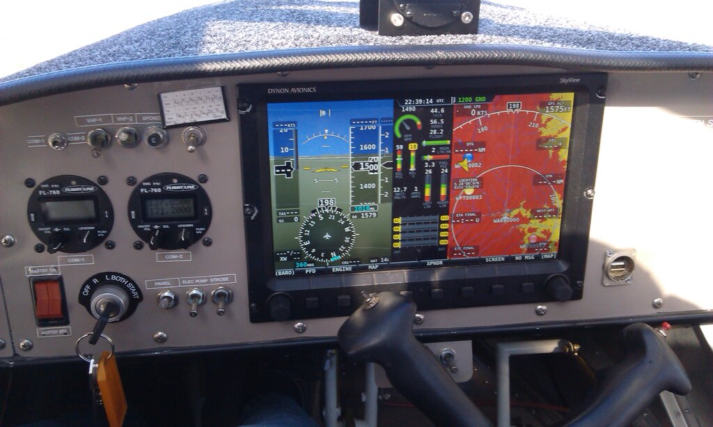

derekliston Posted December 29, 2019 Share Posted December 29, 2019 Ten inch Skyview with dual radios in my CH701. Just working on the KISS principle! 2 Link to post Share on other sites
skippydiesel Posted December 29, 2019 Share Posted December 29, 2019 Ten inch Skyview with dual radios in my CH701. Just working on the KISS principle! [ATTACH]42770[/ATTACH] Any concerns about a power failure ?? Link to post Share on other sites
