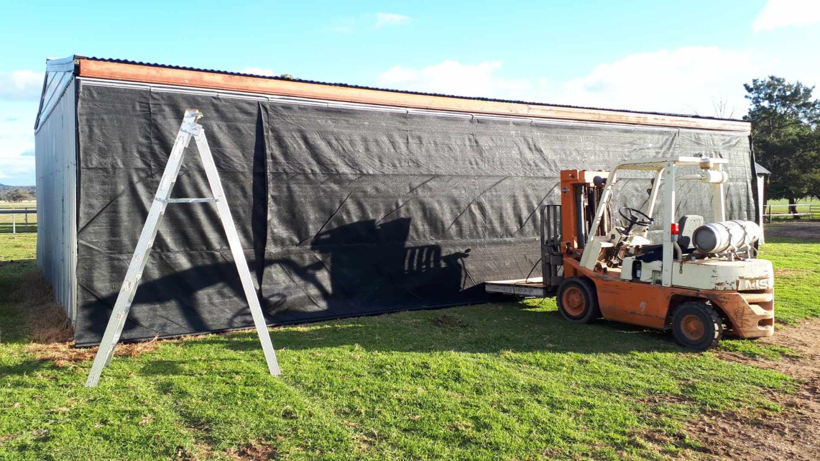

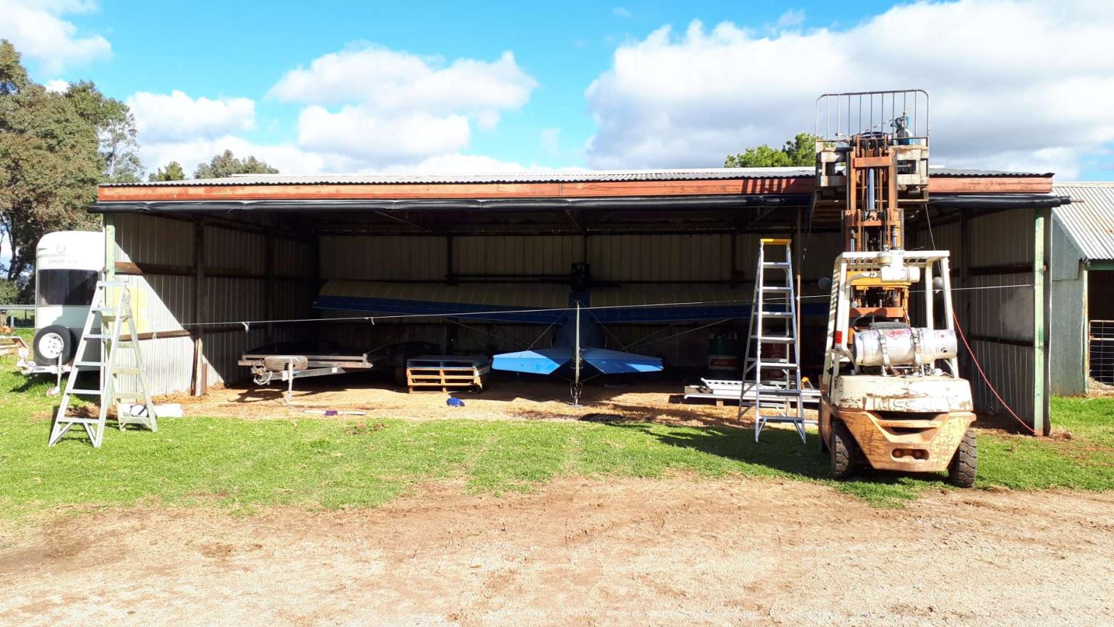

Hi Dan At my last hangar we used shade cloth as the doors. Two piece. Was pulled to the sides to open. The cloth ran on stainless steel wire top and bottom. We had fabric sewn to the top and bottom with eyelets in it to allow 'D' shackles attached. Got the s/s wire at 12mm for a mates sail boat servicing as discarded stay wires at zero cost. Cheers.

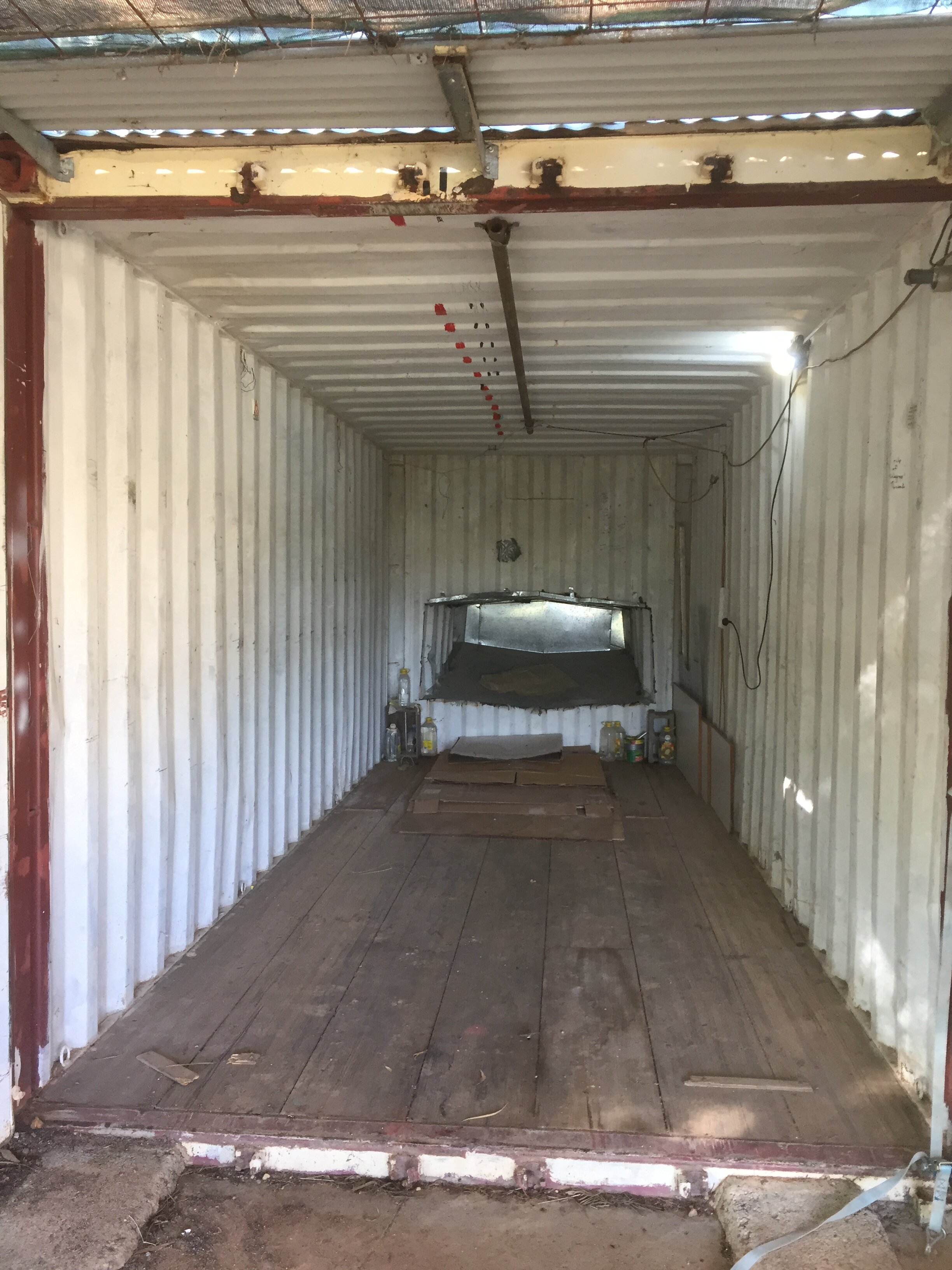

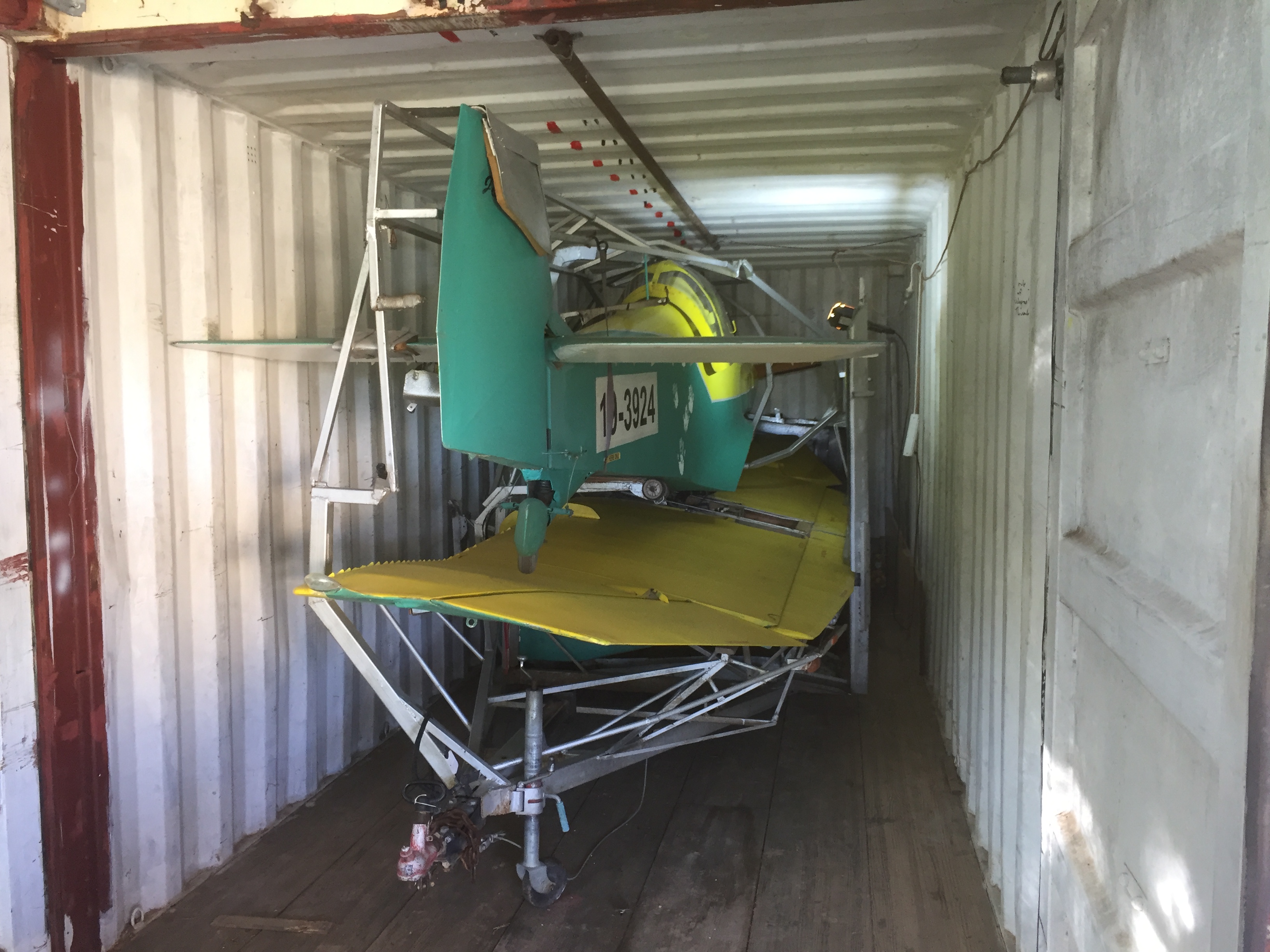

This is my hangar, in which I assembled my carrier and aircraft.
Most of the modifications were installed in here as well. It's a bit of a squeeze, but has several advantages:
I can slide over the wing to get under the instrument panel; it's right next to my workshop, so I can work on my plane pretty much anytime and it's quite secure.

You don't have a hangar you have an "Aircraft Carrier". Good to let slip at the appropriate moment at the Pub.
The Pub? Here's hoping that one day we'll all be able to front up to the bar once again..
Of course, it's an 8m aircraft carrier with built-in aircraft-recovery mechanism.

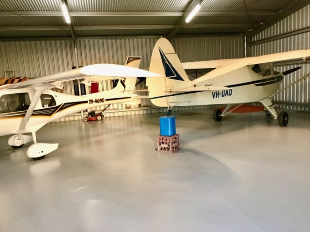

Taken just before the Colt was stripped of its fabric for a rebuild.
Bits and pieces are now everywhere! I am a little OCD so everything is photographed, labeled and packaged ready to put together.
I am a bit of a clean freak and could probably do open heart surgery in it .
Sad as it is, I have planted lawn and done landscaping as well. Recon it's the only way I will get Hangar Of The Year (HOTY) in Hangar and Gardens magazine.

...Bits and pieces are now everywhere! I am a little OCD so everything is photographed, labeled and packaged ready to put together....
Impressive hangar, Ken.
I suspect that a pilot needs to be on the OCD spectrum. The worst case I've seen should have been called CDO: the letters had to be in alphabetical order!

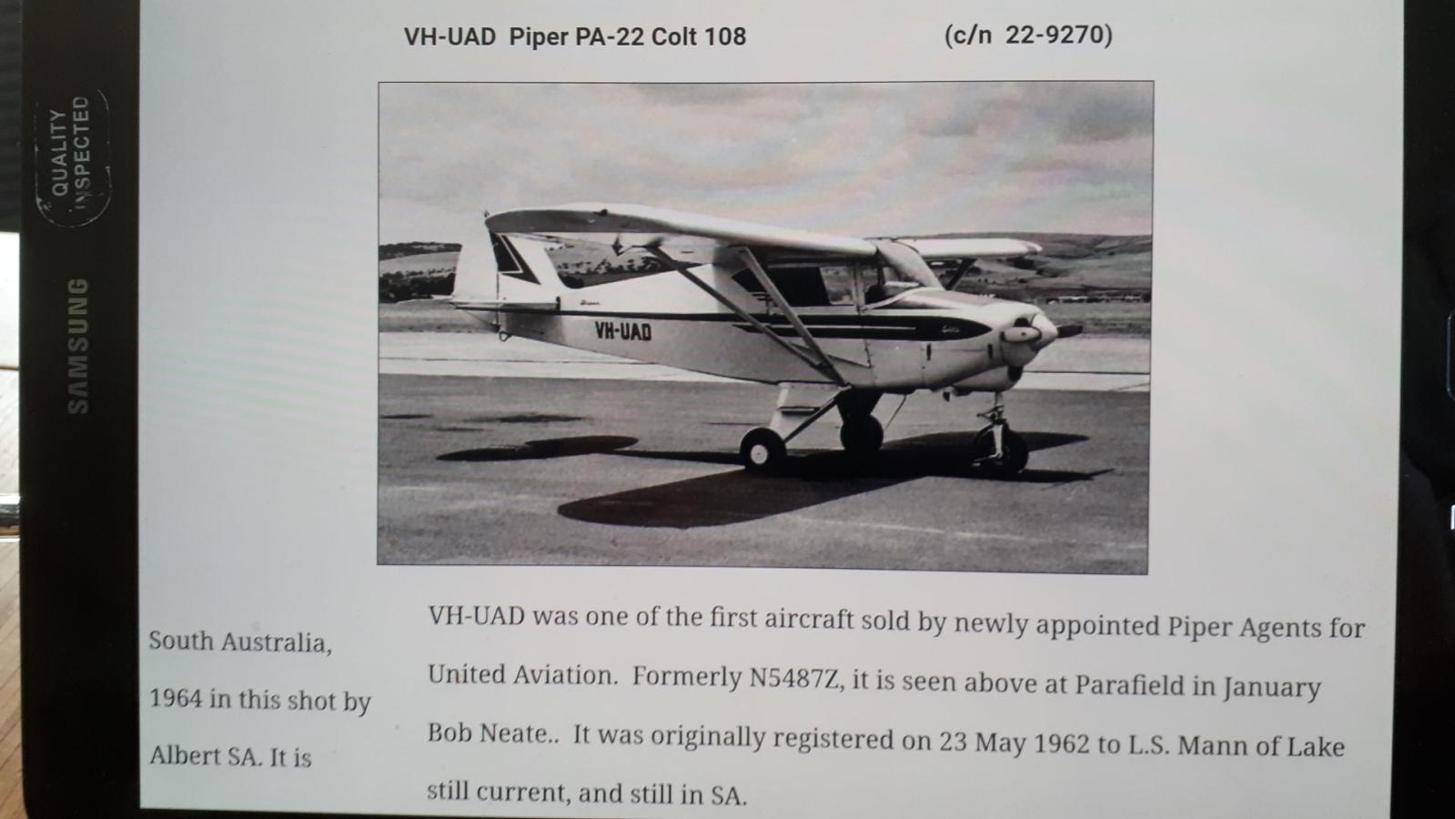

T88, there a a few pics of it around as it has been here for so long, all in SA. It is a low hours a/c and was only taken from the skies due to belly fabric failing the test. I could have just replaced the belly section and it would have been airborne and that was the recommendation of our LAME.
But decided to do the whole thing. Once the fabric was removed is was all good underneath the petticoat. looking at some STCs to make it the best and simplest day VFR it can be. Engine has only 230 hours.
