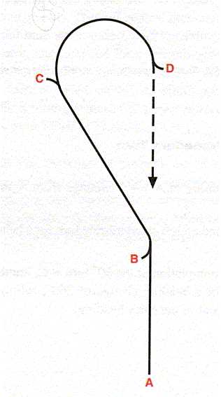

old man emu Posted September 20, 2020 Share Posted September 20, 2020 I found this bit very interesting: the first step was to turn left, count a few seconds, then turn back around 270 degrees to the right in order to line up on final. It sounds very much like an informal application of the formal Tear-drop turn for IFR flight: Teardrop Procedure - When a teardrop procedure turn is depicted and a course reversal is required, unless otherwise authorized by ATC, this type of procedure must be executed. The teardrop procedure consists of a departure from an IAF on the published outbound course followed by a turn toward and intercepting the inbound course at or prior to the intermediate fix or point. Its purpose is to permit an aircraft to reverse direction and lose considerable altitude within reasonably limited airspace. Where no fix is available to mark the beginning of the intermediate segment, it shall be assumed to commence at a point 10 NM prior to the FAF. At B, enter a standard-rate turn for 30 degree change of heading. Time one minute from B to C. At C, enter standard-rate turn for a 210 degree change of heading, rolling-out on the reciprocal of the original entry heading. As usual, intercept the inbound course based on the CDI or ADF. This sort of turn is also used by crop dusters (Go to 2:50 and watch after that) 3 Link to comment Share on other sites More sharing options...
