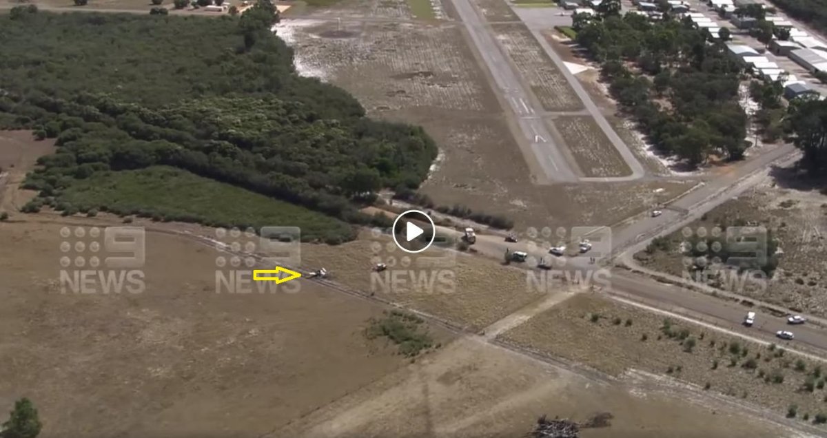

I'm not all that sure about how far into the "impossible turn", the pilot at Serpentine was. He crashed just to the right of the runway, and not far from the end of it.
I'm only guessing that he wasn't too far above Vmc when the engine failed, and the rapid loss of thrust led to a stall, very quickly. There would be no time to deliberate on landing area choices.
The Dyn-Aero stall characteristics could also have played a big part in this, too. The specifications state a stall speed of 47 kts.
The Dyn-Aero is a very light "plastic fantastic" with a high top speed performance, but obviously with low-speed control inability. It's definitely not a STOL aircraft.
There were also some sharp wind gusts around yesterday afternoon. A gust may have hit him at the most inopportune moment.
